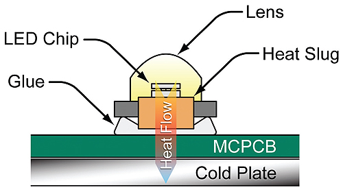

This illustration shows the heat flow path from a power LED. Thermal measurements can help designers determine which types of interface materials will best transport heat and meet system design goals.

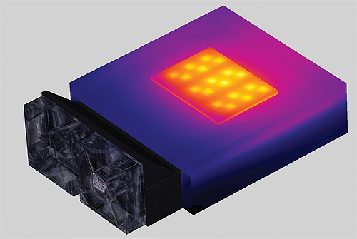

This images shows surface temperature distribution of an IGBT device mounted on air cooled fins. For this simulation, the Mentor Graphics FloTHERM CFD tool used a compact model derived from thermal measurements and cumulative structure functions.

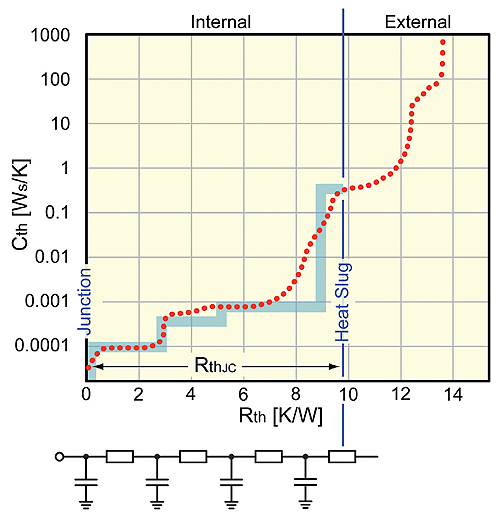

Compact models provide a medium that preserves proprietary component information while delivering performance characteristics the recipient can use to model the device in the application. It starts with a cumulative structure function graph derived from thermal transient measurements. As heat travels away from its source (a junction), it encounters thermal resistances (Rth) and capacitive attributes.
A thermal measurement device can perform measurements to support steady-state modeling. A single thermal resistance value known as RthJC, where the “JC” denotes “junction-to-case,” suffices. If a dynamic compact model of the LED package is needed, the simple RthJC resistance value must be replaced by a proper model of the thermal impedance of the entire junction-to-case heat flow path.
A step-wise approximation of the cumulative structure function can be used to derive a set of lumped thermal resistance and thermal capacitance values for a Cauer-type ladder model spanning several stages.

In the RC model of the junction-to-case path, each resistor or capacitor symbolizes a real physical feature with a now-qualified value.
