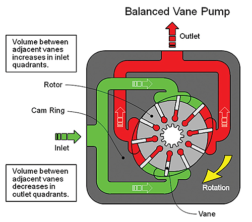

Vane pumps
The most commonly encountered vane-type pump generates flow using a set of vanes, which are free to move radially within a slotted rotor that rotates in an elliptical chamber. A typical configuration uses an elliptical cam ring with the rotor spinning within in a cylindrical housing and a pair of side plates to form the pumping chambers. (Figure 2) The changing volume of the cavity between adjacent vanes creates the pumping action as the rotor rotates.
It is possible to vary the displacement of a vane-type pump, but this is not commonly done except for very specialized applications. The majority of the vane-type pumps used in industrial and mobile applications have a fixed displacement.
Vane pumps can be hydraulically balanced, which greatly enhances efficiency. Some designs place the rotating group in a cartridge, which makes them very easy to repair. The entire rotating group is easily removed and replaced by simply removing the back cover, pulling out the old rotating cartridge and replacing it with a new one.
Vane-type pumps are known for being very quiet in operation and producing very little vibration.

Vane-type pumps are widely used in constant flow/constant pressure industrial applications because they are quiet and easily repaired. They also have the unique attribute of allowing a “soft start” because vane-type pumps typically do not achieve full output at speeds below about 600 rpm. This characteristic can significantly reduce the starting current requirements of electric motors driving a vane-type pump which extends motor life.

Vane-type pumps are the quietest and most vibration-free followed by piston- and gear-type pumps in that order.

Piston and vane pumps offer longest service life of the three technologies and both are repairable.
Usually only a well-equipped maintenance shop has the capability to repair and test piston pumps.
Vane-type pumps are, by far, the easiest to repair. They also have inherent wear compensation built in which helps give them long service life.
