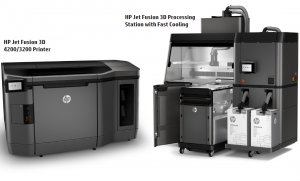

The new Multi Jet Fusion technology uses an inkjet array to apply fusing and detailing agents across a bed of nylon powder, which are then fused by heating elements into a solid layer. The technology’s approach to binding powder results in more isotropic material properties, faster build speeds, and, ultimately, lower costs compared to other powder-based 3D printing processes, according to HP.
The company is beginning with two portfolios soon available for purchase: the HP Jet Fusion 3D 3200 and the HP Jet Fusion 3D 4200. Both feature, according to HP, accuracy and detail, thermal control on a voxel-by-voxel basis, up to 10-times faster printing speeds, lowest cost-per-part, material reusability, an end-to-end solution, and open platform. The 4200, set to appeal to higher productivity levels for prototyping and short-run manufacturing needs and geared toward meeting same-day-business demands, additionally features 25 percent faster printing, up to 5-times faster cooling, even lower cost-per-part, customized and advanced print controls, and the ability to add additional parts to in-progress print jobs to meet quick turnaround.
The price point starts at $120,000 with full systems starting at $145,000. Or, you could have parts outsourced by a company like Proto Labs.
