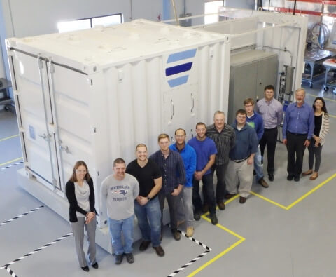

Ambri, a developer of the novel Liquid Metal Battery grid-scale energy storage technology, says it has completed the first testing period of its fully-functioning in-lab “Beta Core” energy storage system, which provides 20 kWh of energy storage with a peak capacity of 6 kW and contains 432 cells. The company assembled its Beta Core after completing a major redesign and robust testing of its high temperature seal for the Liquid Metal Battery cell, which had been a cause for commercialization delays in the fall of 2015.
Successful completion of the Beta Core project at Ambri is a major milestone, and includes designing, building, and testing
a containerized energy storage system with all of the components required for future commercial systems. With this accomplishment achieved, Ambri will now focus on its initial commercial system, which will be available for testing in 2017, and which will have over 500 kilowatt-hours per ten foot container. Ambri systems can be strung together to scale to hundreds of megawatt-hours of energy storage capacity.
The Beta Core project at Ambri involved:
- Reliably manufacturing hundreds of Liquid Metal Battery cells;
- Developing the battery management system, including heater control, state-of-health monitoring, and cell capacity balancing protocols; and
- Designing a thermally-insulated container to keep the Liquid Metal Battery cells at temperature when operated, enabling the system to be ‘self-heated’ (e.g., zero heater power required) when cycled regularly.
