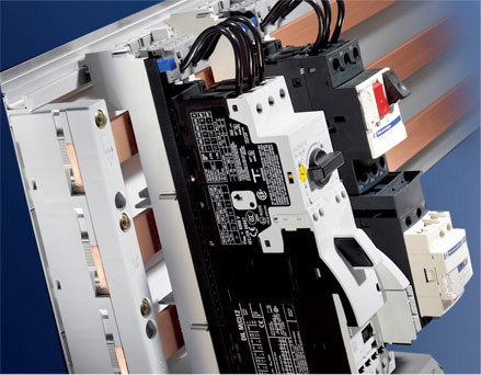

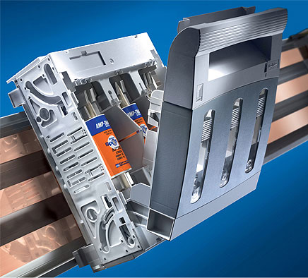

Secondly, standardized components such as fuse bases, circuit breakers, and control modules come with adaptors that let them fasten to busbars of any size. For example, a 700-A, 30 by 10-mm busbar system can connect to the same fuse bases, circuit breakers, and control modules as a 350-A, 15 by 10-mm busbar system with simple, interchangeable adaptors. Moreover, this flexibility and standardization lets busbar systems fit with the electrical regulations of any country. They meet worldwide UL/cUL, CE, and GL requirements for rated current, short-circuit current, and specific busbar/ambient temperature ratings.
Busbars mount directly to the enclosure or a panel. Because they are designed to let all components clip or clamp to them, the time required to drill numerous holes and mount the components to a panel with various types of fasteners is eliminated. By comparison, a block-and-cable system with ten circuit breakers and five fuse blocks need at least 30 drilled and tapped holes — two for each device: A busbar system needs only eight. This considerably reduces the cost of manual labor. Connection adaptors also replace ring terminals and cable lugs, so they eliminate the cost to measure, cut, and strip wires. Similarly, component adaptors save time because they quickly handle DIN-style starters, contactors, and miniature circuit breakers, as well as panel-mounted circuit breakers and fuse blocks. Furthermore, in some cases, the main disconnect circuit breaker may be bus mounted, which reduces panel space requirements and simplifies power distribution to downstream devices.

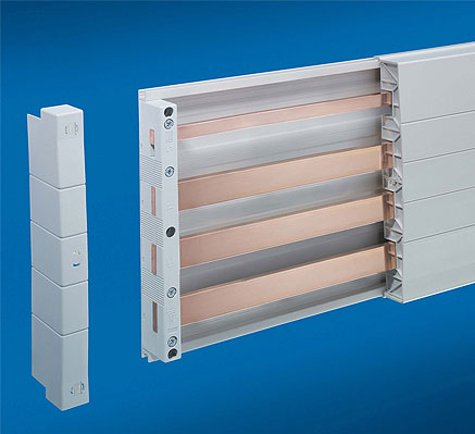

Safety is also designed and built into internationally accepted busbar systems. Bottom, side, and top covers prevent loose parts, tools, and people from contacting live busbars. In addition, locking covers and shrouds surround the connections to circuit breakers and fuses, which make busbar systems much safer than block-and-cable systems that lack similar protection.
