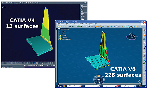

Even CAD programs from the same vendor can represent data differently. Here, a winglet that required 13 surfaces to represent in CATIA V4 requires 226 surfaces in CATIA V6.
