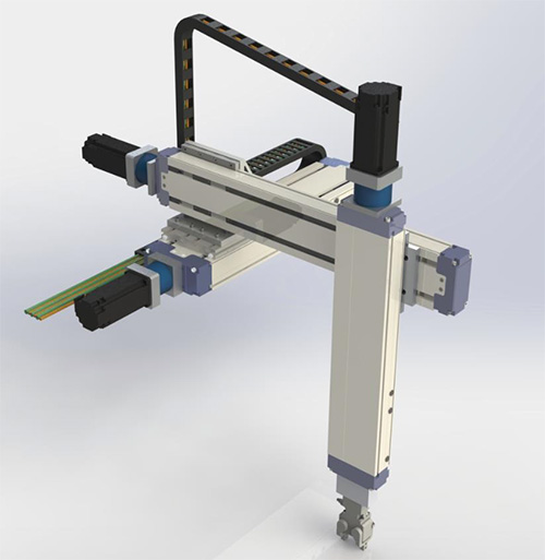

Cartesian robots – Because Cartesian robots typically use just one linear system per axis, it’s important that each axis can withstand high moment loads. This is why most Cartesian robot axes are constructed from linear actuators that incorporate two linear guides in parallel.
