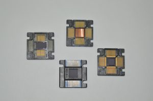

Electrostatic discharge (ESD) is the transfer of accumulated electric charge from one object to another. The transfer can cause damage. The most recognized form of ESD, the human model, results from a person becoming charged and then discharging to another object, such as an unprotected electronic component.
Another form of ESD is the charged device model, where a discharge occurs when the device being protected has a charge and makes contact with a ground path. If an electronic component has stored energy and its terminals make contact with a low resistance ground path, a rapid discharge will occur with an associated current spike. If not designed to handle the spike, internal circuitry can be damaged or destroyed. If, instead, the ground path is resistive, the discharge rate is slowed and damage avoided.

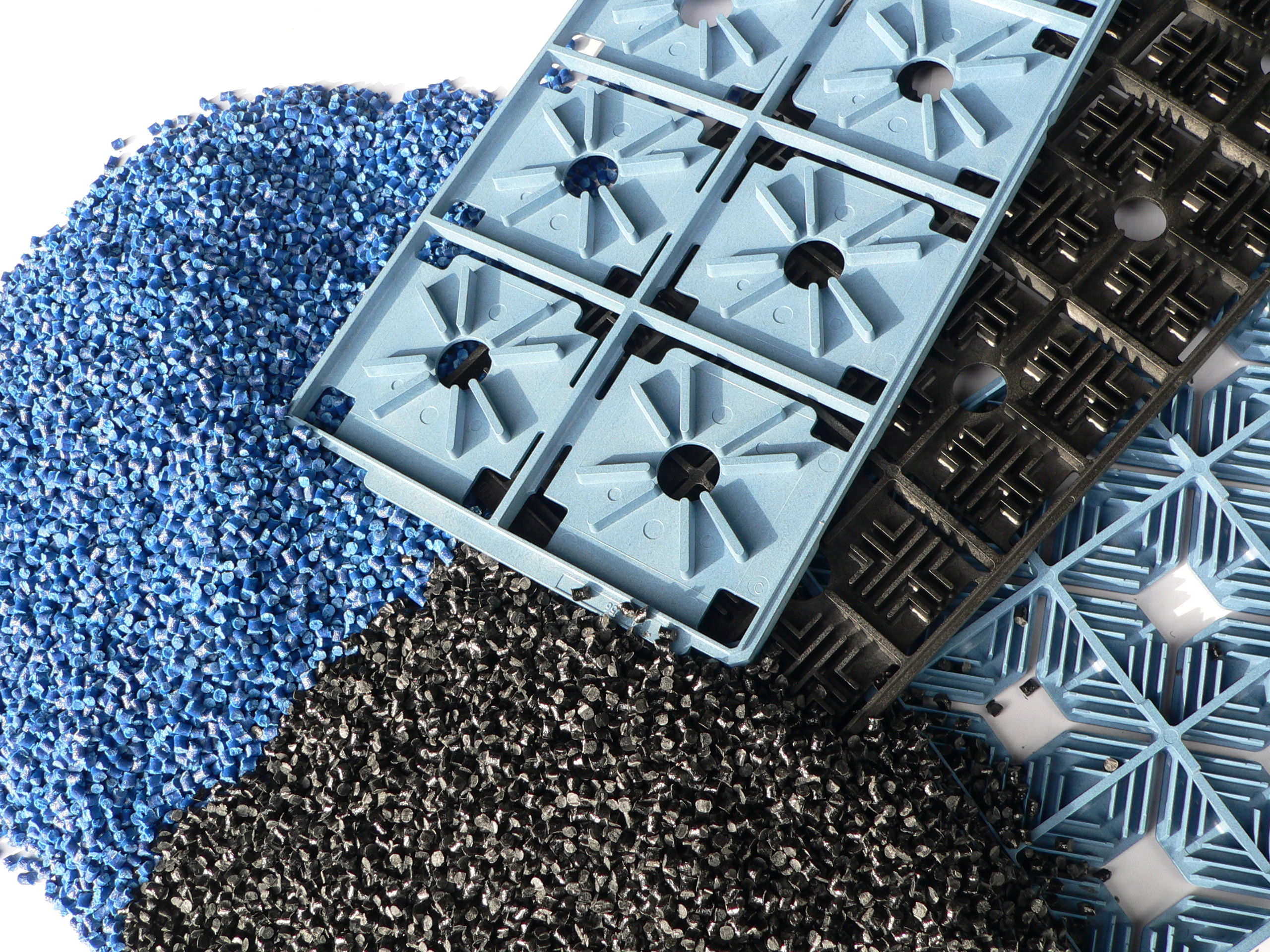

Color options might need to be considered. Carbon fill is the most common conductive mechanism for plastics and the default color is black. For high temperature plastics carbon may be the only option. While it is possible to color the carbon-filled materials, the color palette is limited and too much colorant can degrade the material. Lower temperature materials have additional options, including pre-colored inherently dissipative materials or the use of topical anti-static coatings on standard colored plastics.

ESD protection relies on the ability to conduct an electrical charge. As most plastics are normally insulators, the most common way this is achieved is to add some form of carbon to the material. But the addition of carbon can reduce the effectiveness of a material’s self-extinguishing properties. Here are summaries of the different carbon forms.
Carbon Powder –this form of carbon is very fine, light, and by itself, difficult to handle.
Pros
–Relatively inexpensive – lowest cost carbon option
–Lower conductivity is easier to control– best suited to higher resistivity ranges
–Does not restrict flow much
Cons
–Dirty, powder in sufficient concentration to provide protection sloughs – It rubs off – with the associated risk of contamination – best suited to applications where cleanliness and contamination is not a concern
–Reduced mechanical strength – powder is a filler, not a reinforcement – The higher the powder content (increased conductivity), the more loss of strength
–Makes material black and limits the ability to offer in other colors
