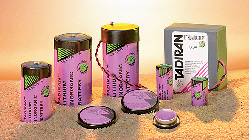

By contrast, industrial grade primary lithium batteries need to be mechanically designed to endure harsh environments, with very high energy density to support a small form factor, very low annual self-discharge for long operating life, and a more robust seal to prevent possible leaks and lost energy capacity. The preferred long-term power solution for a remote wireless device is a bobbin-type lithium thionyl chloride (LiSOCL2) battery, which features the highest capacity and highest energy density of any lithium chemistry, along with a very low annual self-discharge rate, the widest possible operating temperature range, and a hermetic glass-to-metal seal to help prevent battery leakage. Certain battery manufacturers design their bobbin-type LiSOCL2 batteries to deliver 10-year shelf life with a self-discharge rate of 2-3% per year. The XOL Series battery offers a low annual self-discharge rate of 0.7% per year, and can operate maintenance-free for up to 40 years.

The first industrial grade rechargeable Li-ion cell was recently introduced, the Tadiran TLI Series, which is capable of providing up to 20 years of service life with 5000 full recharge cycles, operates and recharges in temperatures ranging from -40 to 85° C, is capable of delivering up to 15 A pulses from an AA-sized cell, and features a glass-to-metal seal to withstand harsh environments.
