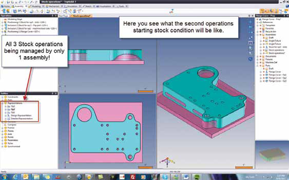

The important characteristic of TopSolid is that it is neither a CAD program with CAM bolted on, nor a CAM program with a limited set of CAD capabilities. TopSolid is a full-function integrated CAD/CAM system, with capabilities and usability that are a match for many best-in-class CAD and CAM programs.
Missler has accomplished this by periodically re-thinking and re-writing the software, based on a new and clean architecture—a process that not many CAD/CAM developers undertake. The newest version of TopSolid is written using C# and the Microsoft .net framework, and provides significant support for multi-core processors. While the new TopSolid architecture allows improved usability and performance, the most important thing it does is allow truly native—and transparent—interoperability of CAD and CAM functions through a common data model.

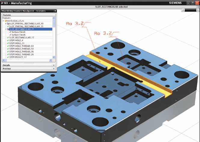

NX CAM supports the use of product and manufacturing information (PMI) to automatically machine features. PMI data can be imported from other CAD systems, or created in NX.

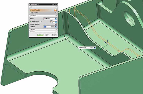

If one thing that has changed NX CAM from being just a big complicated CAM program to being a big complicated and highly usable CAM program, it is the inclusion of Synchronous Technology. Sync Tech (as it’s called) allows NX to intelligently edit CAD models and assemblies imported from other systems—notably Pro/E and CATIA. And it allows NC programmers to easily make changes to either native or imported files, without needing to know how they were built.

Direct editing tools, such SolidWorks user interface conventions, do as NX CAM’s Synchronous Technology, allows easy modification of 3D geometry, even on dumb imported solids.
Another core strength of NX CAM is in supporting model-based development, with semantic PMI. NX can read PMI data from CATIA and Pro/E files, but can also add PMI to imported data that doesn’t already include it. PMI can be used to drive automated NC programming and for CMM inspection programming.

TopSolid-software
TopSolid’s advanced software architecture allows it to manage multiple stock operations in a single assembly.
