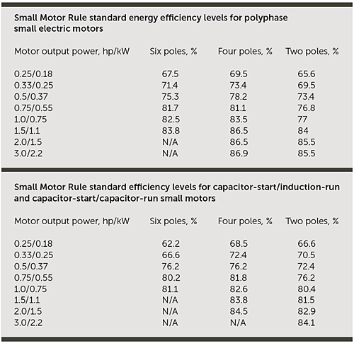

That is something to keep in mind when reviewing SMR provisions, which cover two-digit frame motors and motors having IEC-equivalent frame sizes. The SMR also covers two-, four- and six-pole designs from 1/4 to 3 hp. Covered as well are open construction motors that are either three-phase, capacitor start-induction run or capacitor start/capacitor run designs. And the SMR covers motors that are rated for continuous duty and also meet NEMA Service Factor provisions.
There are still a few exceptions for the Rule. It doesn’t apply to definite or special purpose open construction designs, motors operating at speeds outside those of two-, four- or six-pole motors, enclosed motors, motor types that are not classified as being three-phase, cap start-induction run or cap start/cap run, intermittent duty motors, and motors already covered by other efficiency legislation.
End users won’t need to replace machinery now in use, but replacement motors will have to meet the new efficiency levels.
Applications likely to be impacted by the new rules include those involving pumps and HVAC equipment. Single-phase capacitor-start motors are widely used in both settings. And indications are that the new regulations may affect some motor manufacturers more than others. Officials at Baldor Electric Co., for example, said some of their motors already exceed the efficiency levels spelled out under the new rule. But some kinds of motors will need to be redesigned before they can hit levels spelled out in the SMR efficiency tables.

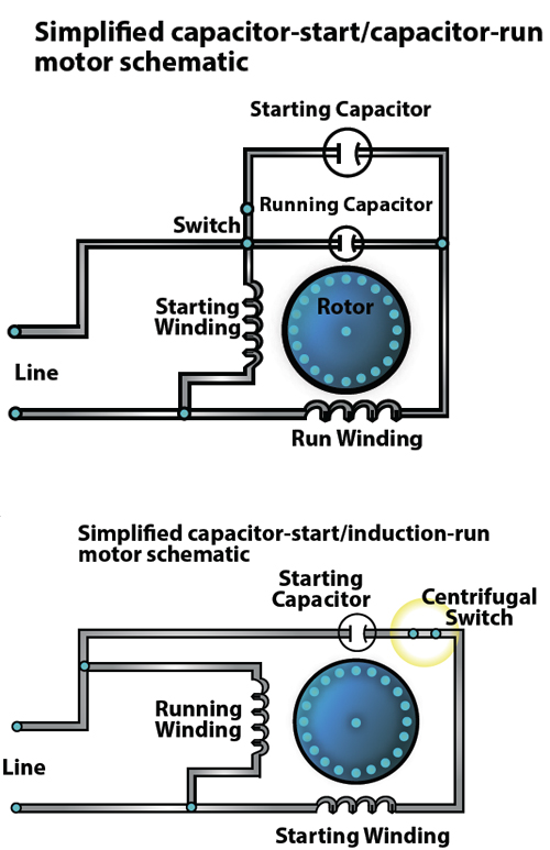

“It is not easy to hit those levels,” said Baldor Electric Co. Senior Industry Affairs Manager John Malinowski. “Four-pole motors, for example, have to hit efficiency levels above those of NEMA Premium, the level used for efficiency tables in EISA legislation. The difficulties involved in hitting those levels may be enough to make capacitor-start/induction run motors impractical. Applications for the those motors may have to transition to capacitor-start/capacitor-run.”
As a brief review, capacitor-start/capacitor-run motors have a capacitor in series with an auxiliary start winding and another capacitor in series with the stator winding. The capacitor in series with the auxiliary start winding lets the motor handle heavier start loads by strengthening the magnetic field of the start winding. The auxiliary start winding and start capacitor are both switched off (usually by a centrifugal switch) once rotor shaft speed reaches a predetermined level (about 80% of run speed).
The run capacitor in series with the stator winding performs a function similar to that of the start capacitor, but for the purpose of reducing running current rather than handling heavier loads. Thus capacitor-start/capacitor-run motors use less running current and are thus more energy efficient than capacitor-start/induction-run motors. But they cost more.
