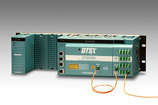

Yokogawa Electric Corporation announces the DTSX200 Distributed Temperature Sensor (DTS) was released to the global market on October 19 and the Japan market in April 2012. The DTSX200 is used to monitor temperature and flow in Oil/Gas Upstream unconventional and conventional in-well applications, LNG and Refinery Tank and Pipeline leak detection, Fire Detection, and other thermal monitoring applications.
With the DTSX200, Yokogawa has developed a product for control applications that uses the optical measurement technologies it acquired over the years in the measurement field. This product can be used at extreme temperature environments like the desert and arctic locations, and in on-shore and offshore applications. The DTSX200 helps improve production efficiency by working together with production control systems.
Yokogawa is the first production control system manufacturer to develop such a distributed temperature sensor for use in Oil/Gas Upstream production and other Industrial applications. The DTSX200 is already being evaluated for use in Oil/Gas in-well production by some of our
customers, and more on-site testing is planned. With the DTSX200 distributed temperature sensor, Yokogawa can offer an even more comprehensive set of solutions ranging from temperature monitoring to production control that help improve production operation efficiency.

With the ability to have stable operation in temperatures ranging from –40°C to +65°C, the DTSX200 is ideal for use in harsh environments. Moreover, with its low power consumption of 16 watts or less, it can be easily powered by a solar panel and battery if no other power source is available.
3. The most compact sensor on the market*
The DTSX200 is just one quarter the size of the AQ8920, making it the smallest such product available today. A compact optical switch module for selecting monitoring points (up to 16 channels) is available for rack mounting with the sensor.
