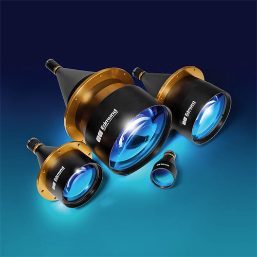

The TECHSPEC® Titan TL Telecentric Lenses are versatile lenses designed for machine vision systems and metrology applications that require a wide field of view. Applications include automotive and electronic inspection, measurement and gauging.
Lenses feature large maximum sensor formats
TECHSPEC® Titan TL Telecentric Lenses have low distortion and exhibit less than 0.1° telecentricity for optimal accuracy. The lenses feature large maximum sensor formats of 1/1.8″, 2/3″, 1″ and 4/3″. Sixteen models are offered in working distances from 111mm to 374mm with a variety of magnification options. A convenient rear filter holder on the back of the lenses allows for easy filter integration. An integrated mounting flange on our 118mm, 182mm and 242mm FOV versions lets users easily secure each lens without an additional mount and provides a convenient reference plane. Shims are included to provide adjustment for camera sensor location variations. An adjustable iris and a three set screw lens mount provides simple rotational alignment to the camera. The RoHS compliant lenses feature a λ/4 at 520nm MgF2 anti-reflection coatings. TECHSPEC® Titan TL Telecentric Lenses are in-stock and available for immediate delivery for fast turnaround and excellent value.
