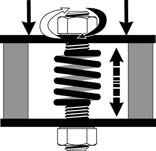

Bolted Joint Mechanics
A bolted joint is basically a wedge wrapped around a cylindrical part. The mating threads effectively wedge the two parts together. Clamp load is generated by applying torque to the fastener, stretching the bolt and compressing the assembly. The more the bolt is rotated, the greater the clamp load on the assembly.
Many believe that by applying a specified assembly torque, a bolted joint produces consistent clamp load. Engineers often take assembly torque directly from charts, assuming a completely linear relationship between tightening torque and clamp load.
When tightening a bolt with a torque wrench, only 10 to 15% of the energy goes into stretching the bolt and producing clamp load. The majority of the energy is converted into heat through friction.

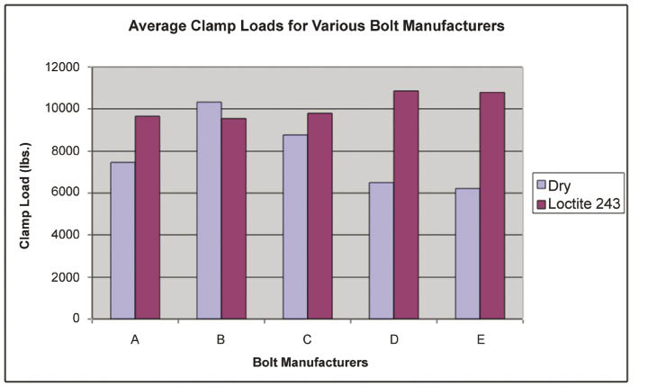

Laboratory study #1: Clamp load variation related to bolt variability
Henkel recently conducted an experiment to verify the theory that differences in surface finish and under-head bolt design produce wide variability when torquing bolts from different manufacturers to recommended levels.
The study used 5/8-in. NC Grade 5 zinc-plated steel bolts and nuts from five bolt manufacturers. At the time of the study, zinc plated steel was the most commonly supplied bolt material.
The bolts were assembled with a calibrated torque wrench to 112 ft-lb (152 Nm), the standard SAE Grade 5 recommendation for steel bolts. As the zinc coating prevents rust, no wet oil film was present.
Each bolt system was placed into a Skidmore-Wilhelm clamp load tester. When the bolted assembly was torqued, the tester determined the clamp load generated by squeezing a hydraulic reservoir that produced a pressure that could be measured and directly correlated with the diameter of the piston.
The first study tested bolts in as-received condition to illustrate the variance in clamp load. Graph 1 illustrates how this produced a standard deviation in clamp load of 21% or 4100 lb.
In the second part of the study, bolts from the same five manufacturers were assembled using a chemical threadlocker. The results shown in graph 2 demonstrate a reduction in clamp load scatter.
In absolute values the range of clamp load data from highest to lowest dropped to 1300 lb with the threadlocker, versus 4100 lb without threadlocker regardless of manufacturer.

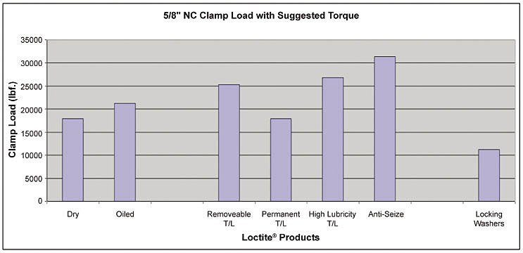

Laboratory Study #2: Impact of lubricity (K) factor on initial clamp load
A practical rule of thumb used for approximating clamp load, “K value” combines all the difficult to quantify variables for clamp load into one number. End users commonly ask for the K value as if it is an independently measurable number rather than a collection of variables.
For critical applications, measure and calculate the K value on site. A single bolt is set up with a run-out gage to determine bolt stretch, and the amount of torque required to achieve this value is experimentally calculated. This setup accommodates all the variables of this exact bolted system and determines appropriate torque.
While suppliers of threadlockers are often asked to provide K values, it is impossible to provide accurate values as suppliers do not control factors such as bolt size, manufacturer, surface roughness, tolerance, surface coatings, cleanliness, accuracy of the assembly tool, and clamp load.
To test lubricity Henkel selected a wide range of chemical threadlockers and mechanical locking systems for use in the Skidmore-Wilhelm tester. This test again used 5/8-in. bolts. (Most standard values for K are calculated on 3/8-in. bolts, but this test was done on a larger size to focus on larger applications.)
The standard formula of K=T/DF was used to calculate the value of K.
Where:
K = Universal Constant
T = Torque in foot pounds
F= Tension of clamp load in pounds force
D= Nominal bolt diameter in feet
With a dry coating like zinc, the assembler can choose to select a dry or wet film coating torque. Testers selected to use wet film specifications to best accommodate the threadlocking material. The appropriate wet film assembly torque was applied with a calibrated torque wrench. K values vary, which is normal. Bolting clamp load is subject to much variability and these values are all close enough once all practical elements are included.
The goal of any material is to be repeatable and close to the standard value. Thus a good result is a K close to what an oiled bolt delivers. A lower K value (indicating higher lubricity) is acceptable, as long as the assembly torque is dropped to ensure bolts are not over-tightened. A higher K value (indicating lower lubricity) means the correct clamp load will not be generated.
In this study, Henkel also tested a newer mechanical locking device involving two interlocking washers with built in ramps designed to stop vibrational loosening. However, this device requires a lot of energy to overcome friction and delivers a substantial increase in K value. If the same torque specification for an oiled bolt is used to tighten the device, a significant drop in clamp force results as shown in Graph 3.
