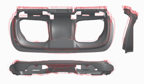

A typically molded ARPRO® foam part, without insert-molded components, will typically shrink about 2% in volume after a standard molding process. However, the addition of plastic or metal components molded into the ARPRO® part cause the part shrinkage to vary locally, resulting in dimensional errors in the final molded part if these effects are not predicted and then factored into the mold shape.
How JSP used ESI VSS to fix the problem
To accurately predict shrinkage, JSP turned to ESI Virtual Seat Solution (VSS). JSP’s first objective was to check the methodology and predictive capability of ESI VSS regarding the final distorted shape of the ARPRO® foam parts after they are manufactured and cooled to ambient temperature. Then, with the help of VSS, they looked into predicting the compensations in mold shape that were required so that the desired product geometry would be achieved after cooling. Last, they wanted to output the predicted compensated mold geometry to a CAD file for mold construction.
Today, using ESI Virtual Seat Solution, JSP can input a targeted part shape, including insert-molded plastic and metal inserts, select the desired density of ARPRO® foam, then run a simulation to predict the corrected mold shape that will be necessary to achieve the targeted part shape after the molding and curing process.
To date, JSP has successfully completed and correlated more than 18 studies to validate ESI VSS’s capabilities. Satisfied with the results, JSP has commissioned and constructed five production-capable molds based on ESI VSS’s output. These first molds have produced dimensionally capable parts as predicted, with no significant costs for revision.
