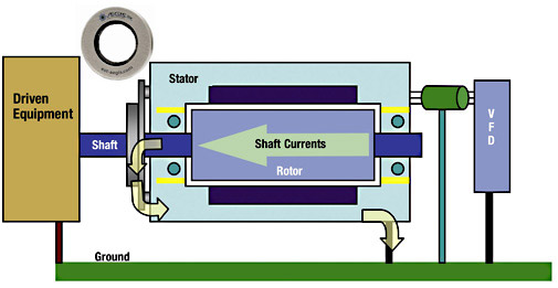

The VFD waveform contains high-frequency components that are capacitively coupled to the motor shaft and discharge through the bearings. They are non-sinusoidal and contain high-frequency currents and voltages called harmonics. And even when the motor is designed for inverters, it is vulnerable to bearing failure from VFD-induced currents.

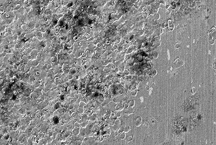

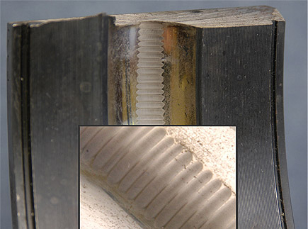

Without some form of mitigation, these shaft currents or eddy currents discharge to ground through bearings, causing pitting, fusion craters, and “fluting.” This leads to excessive bearing noise, premature bearing failure, and subsequent motor failure.

When vibration tests confirm bearing damage by identifying particular energy spikes in the range of 2 to 4 kHz, the damage has usually reached the “fluting” stage. A high carrier frequency means a high discharge rate, so purchase a VFD that permits fine-tuning of the carrier frequency in increments no larger than 1 kHz. In general, keep the frequency as low as possible, and no higher than 6 kHz.

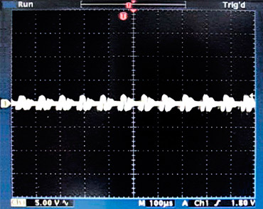

Likewise, the main benefit of voltage tests may be the relief they provide when the results indicate no bearing damage. If a baseline voltage measurement is taken right after a VFD has been installed, successive tests may provide early warning of harmful current loops, but there are many variables. Predicting bearing damage is not an exact science.

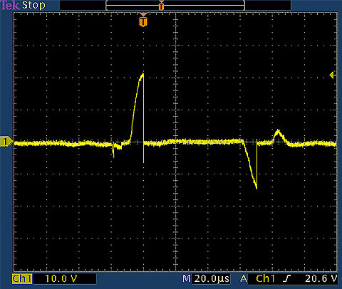

Voltages measured with an oscilloscope probe can be seen to repeatedly build up on the rotor to a certain threshold, then discharge in short bursts along the path of least resistance, which often runs through the motor’s bearings to the frame (ground). Serious bearing damage is probably more likely in systems that operate with high carrier frequencies, a constant speed, or inadequate grounding.

• Alternative discharge paths to ground are preferable to insulation because they neutralize shaft current. These techniques range in cost and sometimes can only be applied selectively, depending on motor size or application. The ideal solution would provide an effective, low-cost, very-low-resistance path from shaft to frame and could be broadly applied across all VFD/ac motor applications. This affords the greatest degree of bearing protection and maximum return on investment.

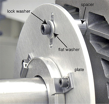

All the above approaches work to some degree, but the most effective solution comes from Electro Static Technology’s AEGIS SGR Bearing Protection Ring™, designed with special conductive microfibers. The ring redirects shaft currents and provides a reliable, very-low-impedance path from shaft to frame, which bypasses the motor bearings entirely.
The AEGIS SGR is scalable to any NEMA or IEC motor regardless of shaft size, horsepower, or application. They are on power generators, gas turbines, ac traction and break motors, clean-room motors, HVAC systems, and other industrial and commercial applications.

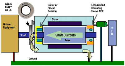

For VFD-equipped motors of less than 100 hp (75 kW) with shaft diameters of less than 2 in. (50mm), a single SGR on the drive end of the motor shaft is typically sufficient to divert shaft currents. Large ac motors (100hp/75kW or more) and even large dc motors, especially those with shaft diameters of more than 2 in., are more likely to have high-frequency circulating currents and discharges that can damage bearings. Motors with roller bearings are also more vulnerable to the circulating currents because they have a greater surface area and their lubricant layer is usually thinner. Such motors benefit from the combination of an SGR on the drive end and insulation on the non-drive end to break the circulating current path. This may also work where installing an SGR on the non-drive end would be impractical because of encoders, fans, or other features.

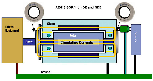

An SGR is also a common solution for motors above 500hp (375kW), and most manufacturers already take this approach. However, when insulation on the drive end is not designed into the motor or cannot be easily installed, two SGRs are recommended – one on the drive end (DE) and one on the non-drive end (NDE).

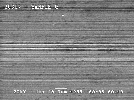

Once installed, the SGR requires no maintenance. Unlike conventional shaft grounding brushes, its conductive microfibers work with virtually no friction or wear. They are unaffected by dirt, grease, or other contaminants, and last for the life of the motor, regardless of motor speed. Test results show surface wear of less than 0.001 in. per 10,000 hr of continuous operation, and no fiber breakage after 25 million direction reversals.
