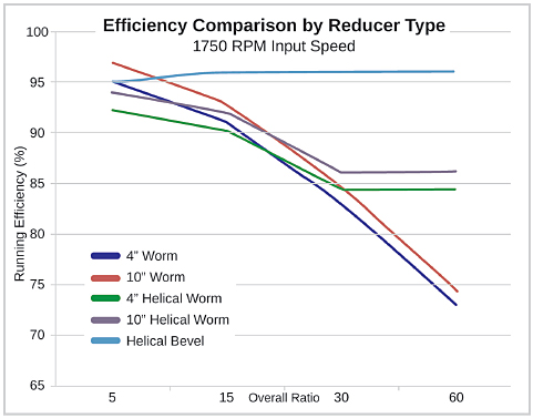

Worm gear/helical gear reducers
An all-helical system has a slight advantage, if efficiency is the only consideration. Efficiency is weighed against cost, durability and other considerations. In general, spur or helical gearing is slightly more efficient than worm gearing per gear stage (see chart on front page). However, the quietness, smoothness, higher overload capacity, higher ratio per gear set, greater simplicity and more compact size of worm gearing can be equally advantageous.
For those applications requiring higher efficiency, the advantages of both systems can be obtained by combining the two gearing types. When worm gearing is used with a helical, spur or planetary gear primary or secondary, higher overall drive train efficiencies can be achieved without loss of basic worm gear advantages. As an example of the advantages of this approach consider an application requiring a 40:1 ratio. To obtain this ratio, all-helical gearing will require three gear sets and four attendant sets of bearings. Typically, the estimated efficiency of this helical gearbox will be about 91% under full load at 1750-rpm input. Overload capacity of this helical gearbox will be 200% of the unity service factor rating (catalog rating). In contrast, a helical-worm gear system for the same ratio will only require two gear sets and two or three sets of bearings. (Reduction to two sets of bearings is possible by mounting the helical pinion on the motor shaft.) This helical-worm gear system will achieve the 40:1 ratio by combining a 4:l ratio helical primary with a 10:l worm gear secondary. In the 4- to 8-in. center distance range, the resulting reducer will be 88% efficient and will have an overload capacity equal to 300% of the unity service factor rating.
