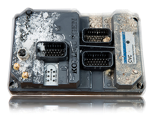

RADFORD, VA – Kollmorgen introduces the CVC600 Vehicle Controller. Just 125 x 50 x 195 mm in size, CVC600 vehicle controllers can fit where other vehicle controllers can’t. The compact controller also boasts a rugged IP65-classified design that is highly immune to vibrations, unstable power supplies, temperature variations, humidity and dust to deliver high-performance, 24/7 operation. As a result it is an ideal solution for automating standard lift trucks with limited space for add-ons that demand compact, robust and reliable vehicle control solutions.
The CVC600 vehicle controller is based on industry-standard technology that can handle any vehicle type, wheel configuration and navigation technology, including laser, spot, range, EyeWay™, magnetic tape or inductive wire. The CVC600 also offers support for WLAN, LAN, CAN, RS232/422/485 communication. This combination of features makes the CVC600 an extremely flexible solution to customize, implement and use.
The CVC600 supports 24 to 48 V operations, with built-in under voltage, over voltage and reverse polarity protection. It is also highly energy efficient, consuming a maximum of 5 W of power and is rated for use in temperatures ranging from -20 to +55°C.
The CVC600 is part of a complete, open-architecture AGV controls platform from Kollmorgen that includes all the software, hardware and services needed for successful vehicle automation. The platform is application-independent, scalable and easy to integrate with host systems and material handling systems. The result is lower total costs for warehouse operations and their customers.
