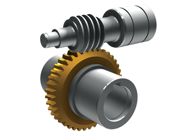

As with all things motion control, there are some clever mechanical workarounds for the backlash problem. The double-enveloping worm gear was developed a few years back to eliminate backlash in the geometry of the worm and spur gear set. Traditionally worm and spur gear reducers have been the workhorse of industry, but the traditional geometry of these systems has been typically low efficiency and high backlash. So the emergence of high efficiency, low backlash worm and spur reducers offers high reduction ratio and low cost in a very compact package.

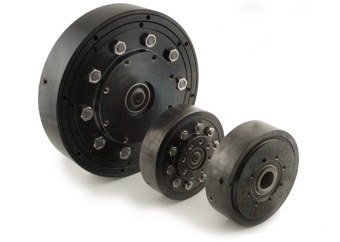

Some manufacturers refer to their products as zero backlash based on its inclusion of a compliant mechanism. The most positive of these is the flex-spline-type reducer. These are made of very thin steel rings with splines on mating surfaces. The outer spline is rigid and the inner spline flexes with several teeth engaged on each side of the circle. They are very power dense and very precise. Because they are typically hollow, lightweight, and fairly stiff, flex-spline gearing is very popular in the robot industry. However, there is a little bit of flexure or spring behavior involved which (contrary to the vendor claims) is technically lost motion.
