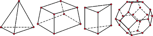

The end result of the process, no matter the tools used, will be a mesh made up of one or more types of geometric elements.
Types of elements
Mesh elements can be 1D (lines), or 2D (triangles, or quadrilaterals.), but most of the time, when starting with 3D CAD data, the elements will be tetrahedra (tets; 3-sided pyramids), hexahedra (hexes or bricks), polyhedra (with any number of sides), prisms, or pyramids (with 5 sides.)
If a mesh is built from hexes, it can be structured (with all elements connected in a regular addressable pattern.) Meshes composed of hexes that are not connected in a regular pattern, or of tets or polyhedra, are unstructured. It’s possible to have hybrid meshes, with a combination of both structured and unstructured elements.
Historically, hexes have been more accurate than tets, but it’s been easier to create tet-based meshes than hex-based meshes. But, at this point, it seems like no more than a generalization. The choice of element type is more often a function of the capabilities of the meshing software and the requirements of the analysis code
