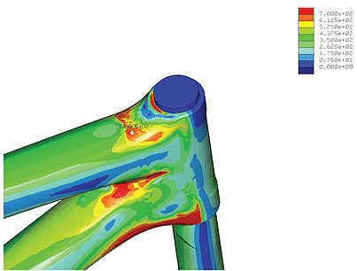

Doing FEA on aluminum welded frames can be a delicate exercise. First a merge model is built from the assembly so the tubes can all be integrated into one another without little shards where the tubes meet. Then some rounds are inserted at tube junctions to “model” welds.
But even when you do all that you don’t have varying weld profiles and penetration like real world welds. We find that Mechanica is able to work with our long thin-wall tubes well because we can set the mesh to start with a small average size. Meshing very thin wall (0.8 mm) tubes up to 750 mm long can be problematic for some packages, but Pro/Engineer actually has a setting that enables the meshing and analysis on a complete frame to go very quickly.
With the new carbon frames, we are able to replicate the loads in our tests by doing a simple force balance using the mechanism function in Pro/Engineer. We feed those forces into Pro/Mechanica, which does the FEA. Then we communicate results to our manufacturing partner’s R&D engineers, who use the analysis along with other factors to determine how/what/where to locate individual plies. The images show different areas where we had test lab failures that corresponded exactly to the analysis results, and were then corrected.
We were able to try six different scenarios for machining/insert length combinations in a couple of hours using Mechanica, chose the best, and prototyped that — all while we had one of our engineers at the factory in China. The revision he carried back passed testing, so we were able to go to production and hold the production schedule.
