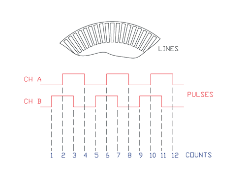

Resolution is one of the most critical factors that must be considered when selecting an encoder and probably the least understood. Resolution is often described in terms of lines, pulses, and counts. Incremental encoders provide a fixed number of square pulses on each channel per shaft rotation, and each unique number of pulses requires a separate code disk. Typically, each pulse has a nominal 50% duty cycle.
Common line counts, the number of lines on the code disk, include binary numbers such as 1024, one of the most common used in incremental encoders, multiples of 360, or even hundreds. For position control, the line count is normally selected to give some meaningful number of pulses per degree of rotation or unit of linear travel such as in ball screws or rack and pinions. Incremental encoders come with single channel output (A) or dual channel output (A/B), with or without complementary signals (A-not and B-not), and with or without an index/marker pulse (M and M-not). Unless the encoder’s electronics multiplies or divides the basic signals, the number of lines equals the pulses per revolution (PPR). Avoid specifying “counts per turn” or “counts per revolution” because counts also may refer to pulses. If counts refer to voltage transitions, “counts” can be two times the pulses for a single channel or four times the number of pulses for dual channels. Make sure you know the number of pulses per revolution needed and communicate what is truly needed to the encoder supplier.
