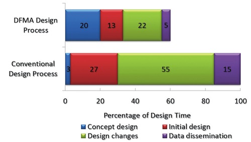

They used Design for Manufacturing and Assembly (DFMA) software to compress development cycles and identify ways to lower material and assembly costs while improving reliability and serviceability.

Shaving design costs
DFMA includes two elements: The DFA Product Simplification module focuses on achieving parts consolidation and assembly simplification through a sequence of detailed questions about function and purpose. The DFM Concurrent Costing module calculates accurate part and tooling costs through a similar process including questions about materials and manufacturing processes.
The software provides a series of cost estimates and comparisons from the start of the product development process and continues to support design and process refinement on an ongoing basis. The cost data is based on examining existing costs, performing separate Pareto analyses, and organizing choices by part category such as fasteners and electromechanical parts.
In the QSI project, “We performed the DFMA analysis at multiple points,” Devenish added. “We used it up-front to generate initial cost estimates and throughout the development process to monitor our progress. DFMA also validated quotes from suppliers. We were able to compare actual assembly times from prototype builds to the DFMA analysis to check the assumptions of our assembly operations.”
