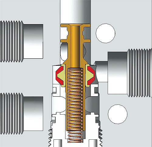

Poppet-design valves
Poppet-design valves use a rubber molded poppet wrapped around the stem that moves along the bore of the valve, creating a seal when the poppet is in its seat. One specific advantage to using a valve with this type of internal design is the compatibility with a variety of media other than compressed air. The unique feature that allows this compatibility is less lubrication sensitivity due to few sliding parts or (dynamic seals).
Another benefit to this poppet design is that the valves are more tolerant of minor air sediment or debris. They also have excellent exhaust capacity and are capable of high flow rates. The poppet design provides a faster response rate due to short stroke and can be mounted in several ways.
Poppet valves more readily lend themselves to 2-or 3-way configurations, although 4-way configurations can be achieved by using dual 3-way poppet sets in one valve body. Poppet valves are typically unbalanced designs, which use the air pressure as the primary force to return the valve to a given position. This concept provides assurances that the valve will return to the desired position, even if the return spring fails. Balanced poppet valves are used to reduce actuation force and achieve lower current consumption in solenoid valves. Balanced valves typically provide smaller overall physical size and produce greater flow capacity.
Applications in which this design are most commonly found are in the medical device and analytical instrumentation industries, where air purity is required (absence of dirty or wet media/air), the need for reliability is mandatory (could be saving lives), low leakage rate is critical, and gases other than compressed air will be used as a medium.

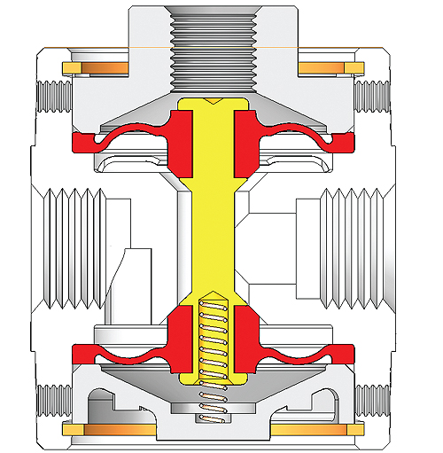

Diaphragm-poppet design valves
Diaphragm-poppet design valves expand the poppet valves’ design by the use of a diaphragm. Its outer webbing guides the poppet to its seat without using sliding seals. Diaphragm-poppet designs are usually unbalanced providing the same assurance of return to a given position as the poppet valve. The diaphragm increases durability especially with different or non-lubricated media.
A variety of durameter and diaphragm compounds make it simple to modify a valve based on the environmental or application requirements for operation. Also, expect extremely low leak rates due to strong sealing control. Diaphragm-poppet valves make 2-way or 3-way configurations available, as well as the possibility of 4-way valves, by using dual 3-way diaphragm poppet sets in one valve body. This valve’s durability and reliability make it a great candidate for applications such as critical life support devices (e.g. heart ventricular support assistance or pulmonary supply devices).
Its non-lubrication capability makes it appealing to be used with devices used for respiratory and anesthesia gases. Diaphragm-poppet designs are great solutions in leak testing devices, due to the very low leak rate. Lastly, these designs are suitable for critical or contaminated vacuum applications.

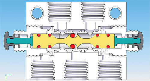

Spool-design valves
Spool-design valves are available in two types: lapped-/shear-design with no seals or dynamic seals/O-rings. Spool valves are designed to be more cost-effective when manufacturing for 4-way valves and are conversely less adaptable for 2-or 3-way configurations. Spool valves can be either balanced or unbalanced, depending on desired position control required. Therefore, understanding this valves’ function is critical to the application requirements. Lapped- or shear-design spool valves can operate without lubrication but are less tolerant of variations in lubrication or by-products of compressing the air at the air compressor. Hence, further conditioning of the compressed air is required prior to use.
Dynamic seal spool valves generally require lubrication. Lapped spool valves have higher leak rates that may make them unacceptable for control of medias other than air, or limited media sources (air/gas tanks/bottles). Consequently, these valve designs are better suited to applications in factory automation where the leak rates are not critical. The requirement for conditioned media also limits their use for vacuum where contaminates are ingested into the vacuum lines and valves.
