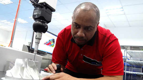

What type of measurement tools do you use on finished parts?
There are a variety of technologies that can be used for ensuring a finished product meets the original design specifications. Laser scanning can be effective for measuring parts with complex geometries. The surface of a part is scanned to create a digital file that can be compared to the original CAD file. However, performing a complete dimensional measurement of a finished part should be a common practice of low-volume manufacturers. This can be completed using a coordinate measuring machine (CMM), which has a massively stable granite table with a flat surface. A precisely made sapphire crystal mounted on a touch probe assures measurement accuracy. To reduce temperature-induced measurement variations, the CMM should be located in a climate-controlled room. To ensure that the finished part matches the original CAD file, the CMM can be programmed to use the coordinates from the CAD file. Programming the machine using the CAD file allows it to automatically measure parts in succession.
