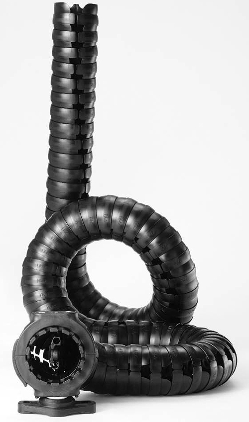

One option for robotic cable carriers is igus’ Triflex R, a modular, multi-axis cable carrier system designed to guide and protect cables and hoses in robotic applications. Triflex R ships and installs as one piece and features an integrated fiber rod that returns cables to a home position after the robot completes a cycle. The system includes mounting plates and brackets, protection links, and a pre-engineered fiber-rod assembly. It is a modular, compact system, but with only one piece to install for complete end-of-arm tooling guidance. The lightweight plastic 3D robotic cable management system is made up of one-piece links that require no additional items such as steel cables or spring mechanisms for support. Triflex R is highly flexible due to its ball-and-socket design, enabling movements in all axes. Its small bending radii and short pitch make it an ideal space saving installation. The modular design also simplifies maintenance; individual links can be replaced as needed, reducing costs; and cables are easily accessed, saving time.
Made up of injection-molded components, Triflex R requires minimal assembly effort; the links simply snap together. Specially designed mounting brackets allow the system to attach to the machine easily, whether needed at the ends of the cable system, or in between.
According to Don Nester, robotic cable carriers like Triflex R offer one distinct advantage over other methods: their movement. “[It’s] twisting the assembly, [It’s] twisting the whole cable bundle when the sixth axis rotates, allowing the cables to be twisted without kinking,” he clarified. “Other solutions in the market, such as the tube-style solutions, aren’t capable of that type of rotation.”
