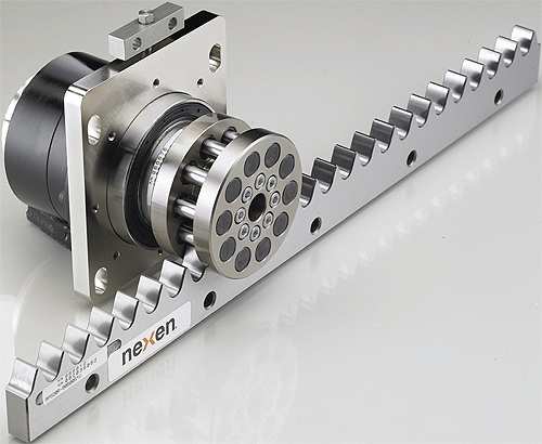

Roller Pinion System

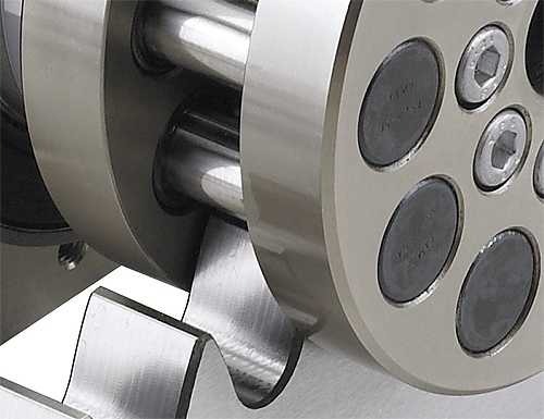

Roller pinion technology is an alternative to traditional rack and pinion systems. Even though they share a similar design principle with the rack and pinion, roller pinion systems replace the traditional tooth profile with bearing-supported rollers, acting like a cam and follower rather than a spur gear.
The unique tooth profile means that there’s no need for clearance between the rack and pinion. The roller pinion’s modified circular tooth profile design ensures at least two rollers remain loaded in opposition at all times to effectively eliminate backlash. Rollers meet the rack with a tangent path and smoothly roll down the tooth face, preventing tooth slap, sliding friction, fatigue, noise and precision errors associated with a traditional rack and pinion designs.
Because each tooth profile is precisely measured to ensure high positional accuracy and eliminate cumulative error, roller pinion technology is engineered to defeat backlash and any subsequent errors resulting from backlash. Therefore, the system provides a consistent torque capacity to provide the desired accuracy and repeatability, without requiring the addition of a second pinion.
In addition, by not needing two pinions, roller pinion systems don’t have to compensate for any performance limitations exacerbated by the addition of a spring element. For instance, when a system must work to overcome the friction caused by the force of a spring, it suffers reduced efficiency. The inherently smooth, rolling motion of the roller pinion systems delivers a low-friction operation that actively improves efficiency, up to 99 percent when converting rotary to linear motion.
