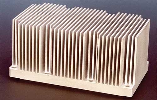

In this extruded heat sink, the fin spacing is relatively close, so it is designed for forced convection (requires a fan) and would be difficult to manually clean and sterilize.

Some extruded heat sinks have larger spacing between the fins. This example is designed for natural convection but adding a fan would increase the performance. It obviously would be easier to manually clean. For both extrusions, the electronic components that are generating the heat are mounted directly to the base of the extrusion.
