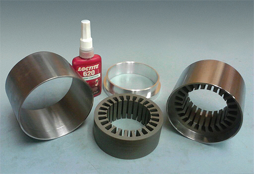

Retaining compounds are liquid anaerobic structural adhesives that cure or polymerize when confined without air between close fitting metal surfaces. These adhesives are made from engineered plastics. Related to interference and slip fits, engineered plastic adhesives let you create joints that are high strength, lower weight and lower cost than traditional interference fits.
Retaining compounds are specifically formulated to join cylindrical, unthreaded metal parts together. These adhesives fill the empty space between mating interference fitted parts and cure to chemically unitize the assembly. Since the combination of the interference fit and the retaining compound is much stronger than the interference fit alone, you need not go to extremes to calculate dimensional tolerances.
The cured retaining adhesive fills the inner space between components and provides a physical and chemical barrier that eliminates fretting, oxidation and galvanic corrosion. The adhesive also seals the interference fit joint against leakage.
Retaining compounds are used in three distinct ways for interference fitted joints:
• added to existing interference fit designs to increase joint strength and reliability;
• engineered into new interference fit designs to deliver smaller, lighter weight assemblies that operate reliably with relaxed tolerances requiring less precise machining;
• used to structurally bond a slip fit that completely eliminates the need for an interference fit.
Bonded slip fits require no machining to tight tolerances and are as reliable and effective as interference fits.
Traditional interference fits generate strength solely from the metal-to-metal contact of surface peaks, an area that represents only 15% of the joint surface area. Liquid retaining compounds fill the surface irregularities and clearance gaps between metal parts, then cure to create a very dense and high strength adhesive bond that increases joint strength and achieves maximum load transmission. The cured resin increases the area of surface contact to 100% so the distribution of stress and joint reliability are improved and part life is increased.
Components bonded with retaining compounds do not require a fine surface finish and allow relaxed tolerances for joining dissimilar metals. Adhesive bonded assemblies experience less stress in the joint and are more robust under differential thermal expansion. This means that softer substrates like aluminum will not be damaged by force or thermal expansion and lose their interference.
Retaining compounds prevent fretting corrosion in interference fits. Fretting corrosion results when micro-movement occurs between a bearing and a shaft or housing, causing small sections of the assembly to weld together. When the assembly moves the next time, these small welded sections rip off and result in a cratered surface. By filling the inner space between interference fitted parts, retaining compounds prevent micro-movement that is the root cause of fretting corrosion.
Retaining compounds can replace brazing and welding with a quick and simple process that does not require specialized equipment, skilled operators, consumable components or equipment maintenance. Unlike brazing and welding, retaining adhesives will not create inherent burn and fume hazards and can be quickly applied and cured.

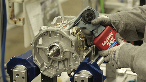

In their liquid form, retaining compounds may be applied using precision manual, semi-automatic and fully automatic dispense equipment.
An example of a fully automated high precision dispenser is the Rotospray applicator, which applies a metered amount of adhesive in a 360° bead or band onto a pre-defined location in the bore of a part. Rotospray application is precise and repeatable and the applicator can be positioned on any axis and operated in either semi or fully automated mode.
Hand pumps are precision applicators for manual dispense that control the volume and location of adhesive. The heart of the hand pump is an adjustable stroke peristaltic pump that dispenses a metered amount of adhesive each time it is manually actuated.
