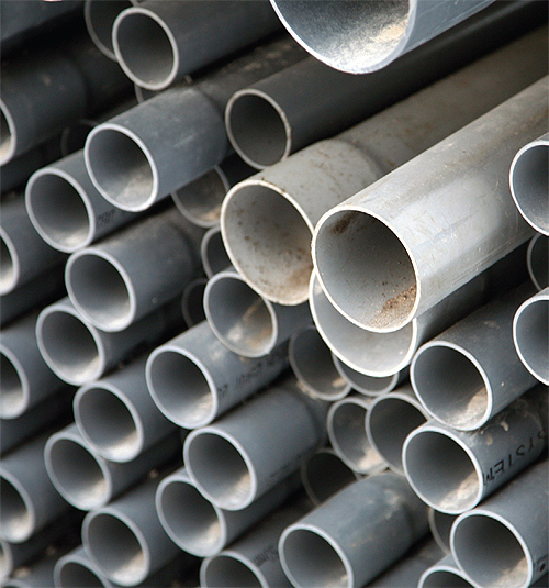

Plastic pipes carry a variety of fluids, from water to gasoline, and pipe manufacturers often need to join multiple polyethylene pipes in a series. A splice is made at the end of one pipe and a collar is bonded to attach the next pipe using the polyolefin bonding adhesive. The adhesive is also used to bond and seal fiberglass reinforced plastic fittings onto polyethylene pipes. These fittings are used as flanges that secure other components. In all these applications, the adhesive must fully seal the joint to prevent leakage and must resist caustic chemicals that could damage the assembly.
