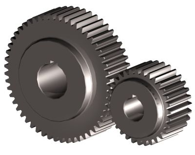

Spur gears are a type of cylindrical gear, with shafts that are parallel and coplanar, and teeth that are straight and oriented parallel to the shafts. They’re arguably the simplest and most common type of gear – easy to manufacture and suitable for a wide range of applications.
The teeth of a spur gear have an involute profile and mesh one tooth at a time. The involute form means that spur gears only produce radial forces (no axial forces), but the method of tooth meshing causes high stress on the gear teeth and high noise production. Because of this, spur gears are typically used for lower speed applications, although they can be used at almost any speed.

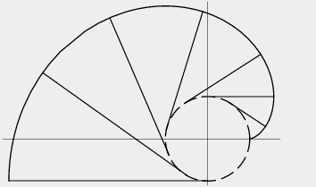

An involute gear tooth has a profile that is the involute of a circle, which means that as two gears mesh, they contact at a single point where the involutes meet. This point moves along the tooth surfaces as the gears rotate, and the line of force (known as the line of action) is tangent to the two base circles. Thus, the gears adhere to the fundamental law of gearing, which states that the ratio of the gears’ angular velocities must remain constant throughout the mesh.
