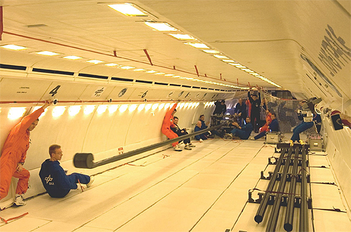

Deployable inflatable boom test carried out in mid-air over the Atlantic Ocean in an Airbus A300 ZERO-G aircraft by a team from Institute of Composite Structures and Adaptive Systems at the German Aerospace Center (DLR).

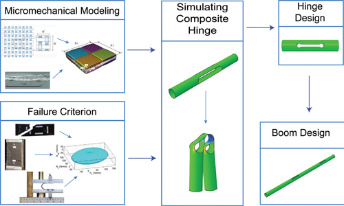

The modeled boom was a one-meter long, thin-walled (0.22 mm) tube (38 mm diameter) made of two plies of plain-weave carbon fiber in an epoxy matrix. Certain regions of the tube were weakened by cutting away some of the composite material to form tape-spring hinges so the tube could be folded around the satellite without causing any damage. Three possible hinge designs, with different slot parameters, were considered. The FE mesh was made finer over the hinge regions to capture the details of the complex deformation occurring in these regions.
Early research used micromechanical modeling to capture the behavior of the boom’s thin laminate material through homogenization of a periodic unit cell (using Abaqus/Standard). From this, the material stiffness was computed in the form of a matrix and used to define the shell elements in the Abaqus/Explicit simulations of the quasi-static folding and dynamic deployment. The numerical simulations were then integrated with a material failure criterion. The combination of these tools allowed an analysis of the detailed effects of hinge design changes on three different boom models. This led to identifying the design that could be most safely folded and deployed.

Summary of several years of Caltech research using Abaqus FEA to develop a deployable composite boom for satellite hardware deployment.
