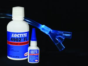

LOCTITE 4902 FL is an innovative CA adhesive recently developed by Henkel Corporation. LOCTITE 4902FL is a highly flexible cyanoacrylate adhesive designed for the assembly of flexible medical devices. LOCTITE 4902 FL offers significant performance enhancements compared to standard CAs including strength in flexing bond lines and resistance to leaks with excellent sealing capability.

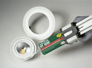

[bctt tweet=”Cyanoacrylate/Epoxy hybrid adhesives are one of the newest breakthrough innovations in the cyanoacrylate adhesive industry. ” username=”@DW_MikeSantora”]LOCTITE HY 4090, the first of Henkel’s new range of hybrid adhesives for the manufacturing industry, combines the technology of cyanoacrylates and epoxies in a single product. The resulting hybrid delivers a combination of properties unique to this technology and offers an alternative to more traditional structural adhesive products.
LOCTITE HY 4090, a patent protected formula, is a two component, general purpose adhesive that provides a very fast fixture at room temperature. It is designed to bond a variety of substrates including metals, most plastics and rubbers. LOCTITE HY 4090 provides good temperature and moisture resistance which also makes it suitable for applications in high temperature/humidity environments. Its thixotropic nature makes it suitable for applications where good gap filling properties on rough and poorly fitting surfaces are required. [6]
