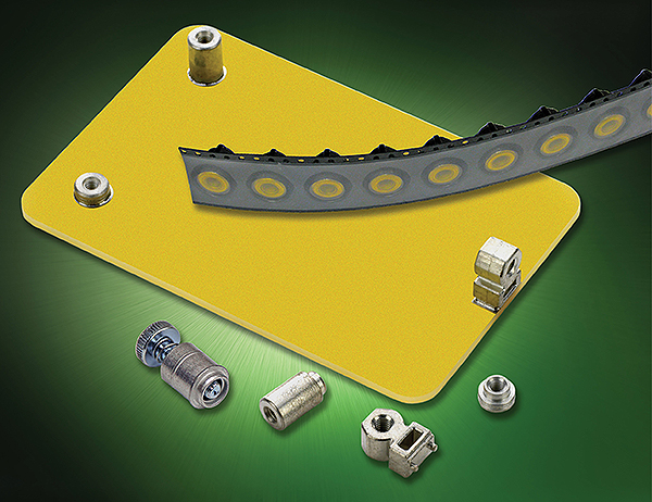

Surface mount fastening technology removes all the risks and delivers production and quality rewards. The hardware—supplied on tape and reel consistent with SMT automated installation equipment—is positioned where designed while the board is processed and then permanently installed with pick-and-place robotics in the same manner and at the same time as other surface mount components prior to the automated reflow solder process. The fasteners simply become another non-intrusive component on a board. And since the parts are packaged on a tape and reel (neither loose nor dumped into bowls), any chance of mixing the parts with other hardware disappears.
Functionality by design
The portfolio of surface mount fasteners is growing and many types and styles have been engineered, each serving one or multiple purposes. Depending on type, surface mount fasteners can be specified to mount, stack or space boards; attach components to boards; or create right-angle attachment points on boards. Some integrate captive screws—eliminating loose screws and all the related hassles—ideally suiting applications where removal and reinstallation of boards is anticipated.
• Surface mount spacers, nuts and standoffs. These threaded or unthreaded types offer the capabilities to stack, space and attach and can be installed in boards as thin as 0.020 in. (0.5 mm). Reels carry up to 3,500 parts, depending on fastener size. A polyimide patch is supplied to allow reliable vacuum pickup. Fasteners are available either in brass or steel.
• Surface mount captive panel screw assemblies. These fastener assemblies, available in several styles, can be installed in boards as thin as 0.063 in. (1.6 mm) and permit easy removal and reinstallation of boards. They can be provided as a two-piece assembly with a plastic cap or as a spring-loaded, all-metal fastener that is installed preassembled in one piece. The screws can be finger or tool actuated after installation.
• Surface mount right-angle fasteners. These provide an efficient and reliable method to create permanent right-angle attachment points on printed circuit boards as thin as 0.040 in. (1 mm). They provide reusable threads parallel to a board to accommodate a component for mounting 90º to the board. They can serve as viable alternatives to conventional angle brackets or threaded right-angle blocks for attaching board to chassis, chassis to board, or component to board.
The shape of right-angle types readily allows the part to be picked up by a pick-and-place machine without requiring a patch. The fastener is presented in the tape and reel with two small pins downward and the flat portion of the fastener’s head exposed to the pneumatic finger. The two pins at the bottom act as two very small pilots, providing stability and locational accuracy during placement. In addition, a “step” along the bottom allows the solder fillet to be formed along this edge, even while the face of the fastener is flush against an edge of the board. The fastener’s rectangular hole reduces the mass and promotes quicker heating to minimize heat draw away from surrounding components on the board.
