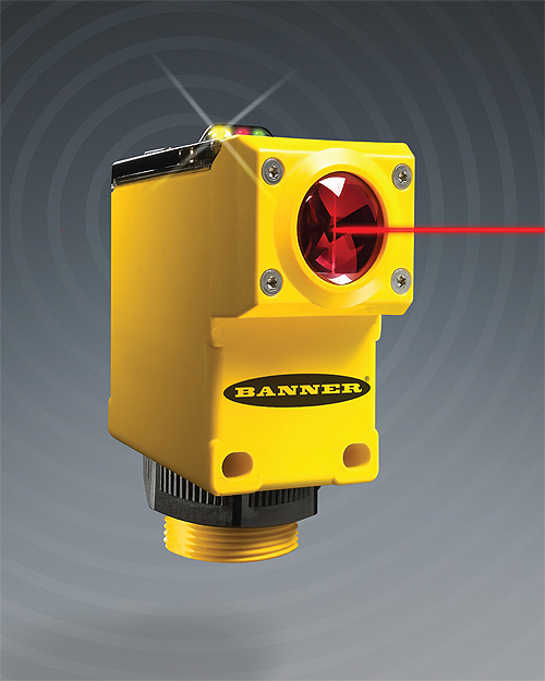

Self-contained, “Peel And Stick” sensors
Using this knowledge and technology, a new generation of wireless was created: the wireless photoelectric sensor. Combining photoelectric sensing and wireless technology into a single housing, this completely, self-contained system works out of the box, operating entirely on battery power.
With no configuration software required for setup, the wireless sensor is easy to install. Operators simply bind (or pair) a wireless sensor with a wireless gateway. Then, the sensors output appears at the gateway output terminal. The sensor provides up to 3,000 ft/1 km line-of-sight sensing distance to its paired gateway. By eliminating the need to wire sensors, operators can easily add a single photoelectric sensor in minutes, creating a scalable, wireless sensor network infrastructure to monitor environments. Users can now apply sensing technology in situations where it was not previously possible—all while reducing installation and maintenance costs.
For flexible performance, there are multiple photoelectric sensing modes supported including retroreflective, convergent and fiber. Additionally, a model is available that takes in dry contacts, for example from a push button, or works with inductive proximity sensors. There are also two gateway models available: two out and six out with Modbus RTU. The two out model is suitable for entry-level single wireless links. One output indicates the state of the sensor, while the second output provides a fault signal if there is a problem. The six out model with RTU can connect up to 47 sensors. The status of the sensors is reported to the PLC using a Modbus interface. If an application requires more than 47 sensors, multiple gateways can co-exist in the same physical area without interfering with each other. For future growth, the system can support analog and digital data, removing the limits to the types of sensors that can be made wireless.
