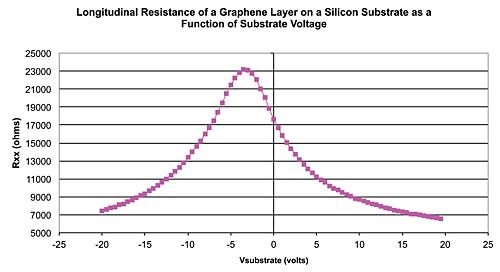

Figure 5 illustrates an alternative approach for a setup for measuring resistance as a function of electric field effects on a graphene-based FET structure. While the gate voltage is swept, a constant current is applied to the graphene and the resulting voltage is measured in a 4-wire configuration. The source current needs to be kept low as well to minimize power dissipation. From the source current and measured voltage drop across the graphene, the resistance is calculated.
Figure 6. Longitudinal resistance of a graphene layer on a silicon substrate as a function of the substrate voltage.
Figure 6 is a plot of the longitudinal resistance of a graphene layer on a silicon substrate as a function of the substrate voltage, which illustrates graphene’s ambipolar property—it conducts when either electrons or holes are induced into it. The large slope on each side of the peak (Dirac point) indicates a rapid decrease in resistance as the magnitude of the gate voltage increases. The data illustrated were taken using Keithley’s Model 2636A two-channel System SourceMeter® instrument at room temperature on a sample of graphene with gold metallization and wires connected to the gold.
Graphene absorbs moisture easily, which can produce a shift in the Dirac point (the top of the curve). If it seems likely that a shift in the curve is due to moisture absorption rather than experimental controls, annealing the samples can remove the moisture.
