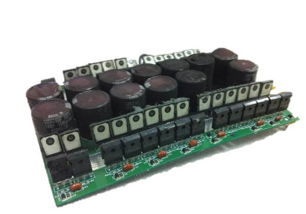

Occasionally even usually reliable pitch-motor drives run into trouble. The original unit in this case had an extremely short lifetime, frequently less than two years. An accompanying image shows that capacitors would leak electrolyte on the circuit board causing a short circuit. Catastrophic failures meant many of the units received were unrepairable. To make matters worse for the client, replacing the drives is difficult because they are up tower in the hub. Technician labor made them expensive to replace.
The original design used poorly rated capacitors and transistors. The inefficient design generated a lot of excess heat. Lastly, a threaded hole on the heat sink for a ground lug was easily stripped because it’s just tapped into aluminum.
Our redesign consists of manufacturing a power board with a set of new FETs (field-effect transistors). These FETs generate less heat than the originals due to lower On-Resistance and improved capacitors can handle higher ripple current. Manufacturing the board means it was possible to repair some of these catastrophic failures that would otherwise be unrepairable.
The redesigned circuit board used thicker copper traces which helps pull heat from the transistors and capacitors. What’s more, the much higher efficiency of the redesign means the units run about 25°C cooler than the OEM design. The result has been that over 3,000 units are in the field with a meantime between failure improved by over 80%. Lastly, to prevent stripping the threaded hole, we drill out and install a steel insert which prevents damage.
