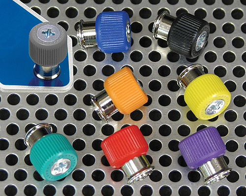

Colored plastic caps are available for fasteners to help with branding and maintenance by designating service levels or operating or maintenance instructions.

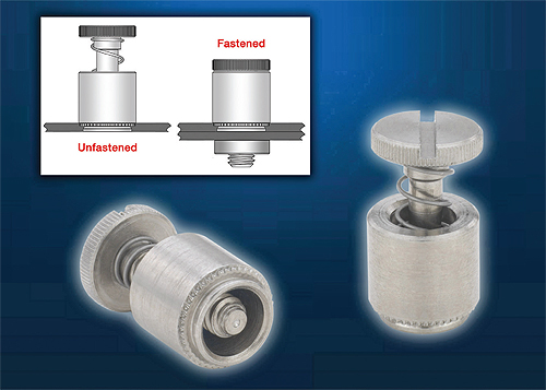

Self-clinching types will install flush (when using shortest screw length) on the backside of a panel—no protrusions on the side of the sheet opposite installation—and will require minimal panel preparation. No secondary operations will be necessary, which can help maximize productivity along the line. The fastener is inserted into a properly sized hole in the mounting sheet and, by applying sufficient squeezing force from a press, becomes a permanent part of the assembly. As a result, the sheet material surrounding the hole is forced into the fastener’s undercut, securing against axial movement and against rotation by a displacer.
self-clinching-pins
Example of a self-clinching type in this family of fasteners. Inset diagram illustrates “unfastened” and “fastened” modes.
For any self-clinching fastener the relationship between fastener and sheet material will be critical. Three basic requirements will be necessary for successful outcomes:
• Metal sheets into which the captive panel fastener will be installed must have adequate ductility to allow the displaced sheet material to cold flow into the undercut.
• Metal sheets into which the fastener will be installed must be sufficiently softer than the fastener so that the fastener itself does not deform during the installation process.
• Sheets must meet the minimum sheet thickness required by the particular fastener. As an example, one basic type of captive panel screw assembly requires a minimum sheet thickness of 0.036 in. (0.92 mm). Typically, there is no specified maximum thickness required for clinching into sheets. Sheet thickness may become a consideration, however, depending on the fastener’s screw length.

As an alternative to metal caps, colored plastic (PC/ABS) versions have been developed to advance maintenance, functional and/or branding requirements. The plastic caps can be specified in black, red, orange, yellow, green, blue, violet or metallic as standard or custom colors can be supplied. The colors offer the capability to designate service access levels for equipment, color-reference operating and/or maintenance instructions, or conform to end-use aesthetic requirements, among other possibilities.

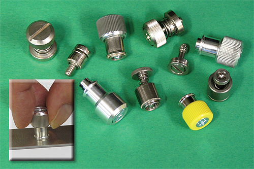

A look at the various types of panel fasteners with captive screws. Inset shows an example of a type that can be hand and/or tool actuated.
As a lower-cost alternative to multi-component fastener assemblies, a spinning clinch bolt with one-piece captive screw can provide a practical solution. These fasteners for metal panels benefit from controlled clinching action during installation, which captivates the screw permanently while allowing it to spin freely in the host metal sheet. They provide a reliable means of attachment without use of a retainer or washer (contributing to lower manufacturing costs) and can be supplied with an unthreaded neck for axial float or with a jacking feature or spring for self-retracting. As with some other types, these will be appropriate for close centerline-to-edge applications.
