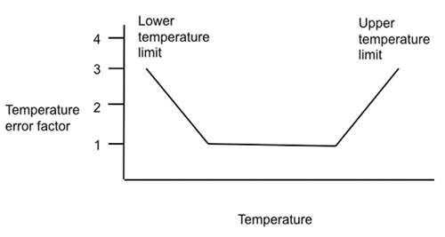

Total Error Band (TEB) accuracy specifies the maximum deviation of the output values within limits defined by the sensor’s underlying technology. In some instances, an error band multiplier increases the allowed inaccuracy at extremes such as increasing the temperature error at low and high temperatures as shown in Figure 4. The error band may also increase at pressure or other upper or lower limits.
sensor-temperature-error-factor
Figure 4. The temperature error factor can increase the allowed sensor error by a value such as ±3 times at the temperature limits.
