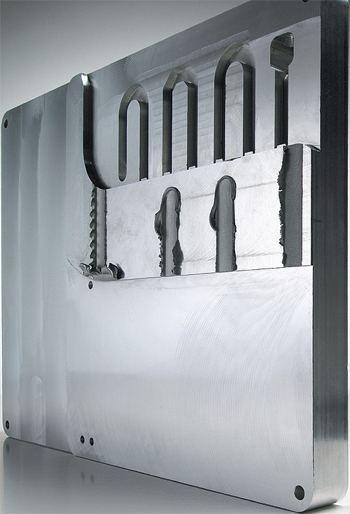

FSW is a method of joining two pieces of metal with no filler metal involved at all, subjecting components to heavy plastic deformation at high temperatures. “The key point here is [the process] is lower than the melting point. The process itself uses a rotating tool that is plunged into the components and friction is generated,” said Jackson. “It really is that simple. The tool produces a severe plastic deformation under high pressure, which welds the two materials together.”
How it works
Jackson said that the weld probe and fixturing is critical in FSW. When joining two pieces of aluminum, the weld probe generates heat through friction, creating a homogenous structure.
“Because aluminum has naturally high thermal properties, the heat actually is naturally pulled away from the weld probe so you get the fine microstructure,” Jackson said.

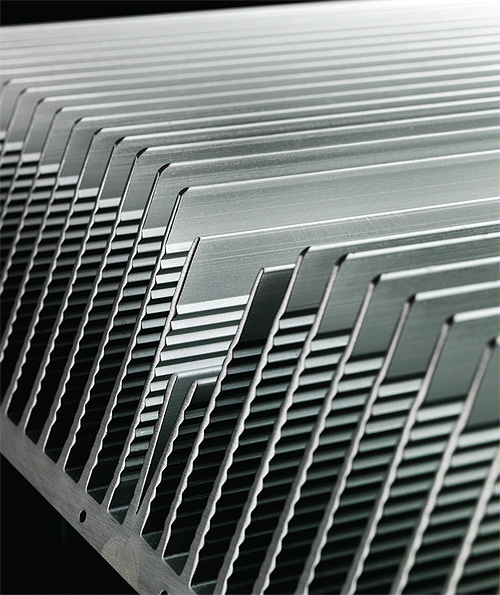

Modular versus bonded fin heat sinks
FSW of aluminum extrusions is being used more and more to take advantage of the excellent thermal properties of aluminum. Aluminum is used worldwide in large heat sinks because it offers high thermal efficiency and no porosity. It is also easy to manufacture aluminum into custom shapes, is lightweight and has low material costs. Although copper may have better thermal properties, its inconsistent price points inhibit its wider use. In addition, copper is heavier than aluminum and cannot be extruded.
Extruded aluminum offers a mix of advantages and disadvantages. For example, said Jackson, extrusions are superior to castings and bonded fin heat sinks and is available for total lower cost. The challenge comes, however, because typically in North America, aluminum extruders go up to about 4:1 ratio or even 10:1 ratios. Just a handful of aluminum extruders, SAPA included, can extrude fin ratios up to 16:1 and occasionally 19:1. Previously, this met most thermal applications; however, as electronics continued to get hotter, the thermal management industry developed bonded fin heat sinks. Bonded fin heat sinks can reach ratios of 40:1; however, this process is labor intensive and requires products to be “super-glued” together with thermal epoxy.
To reduce labor costs, SAPA developed its own modular heat sinks that offer ratios up to 60:1. Through testing, the company was able to prove that FSW module heat sinks are 8% thermally more efficient than bonded heat sinks because there is no filler material, like the thermal epoxy.
Cold plates are yet another example of advanced thermal technology using FSW, especially in vehicles. Previously, cast cold plates were used, however porosity on large castings proved to be expensive. FSW is used to weld end caps on the extruded cold plate. Recent tests showed the product withstood pressure testing up to 2,700 psi.
