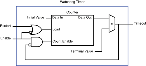

In general, a watchdog timer (or just “watchdog”) consists of a digital counter that counts from an initial value to a terminal value at a rate determined by a fixed-frequency clock. Typically the counter counts down from the initial value to zero, and the initial value is programmable so that the program can configure how long it takes to count to zero. The watchdog will “timeout” when the counter reaches zero, causing it to assert its timeout signal and halt counting. The timeout signal is connected to external circuitry so that it can initiate corrective action.
A program can restart the timer at any time by loading the initial value into the counter; this is commonly called “kicking” the watchdog. The watchdog is kicked by momentarily asserting its restart input (usually by writing to a watchdog control register). During normal operation, the application program regularly kicks the timer to keep it from reaching zero, typically as part of a control loop. If a fault condition prevents the program from kicking the timer, then the watchdog will timeout and initiate corrective action.

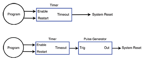

The most basic watchdog circuit has a single timer that invokes an immediate computer restart upon timeout. The timeout signal is connected to the computer’s system reset input, either directly or through a conditioning circuit, so that a computer restart will occur when the watchdog times out. This architecture depends on the system reset to force control outputs to their safe states. Some computers will power-down if a continuous timeout signal is applied to the system reset input. In such cases, a pulse may be required to initiate a system restart. A pulse generator can often be used to satisfy this requirement.

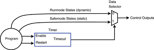

A superior alternative is to define two different sets of control states, “Runmode” and “Safemode,” and employ a data selector to route the state sets to the outputs under watchdog control. The program can modify Runmode states at any time, but it can change Safemode states only when permitted by a special write-protect mechanism. Typically, the program will begin to control the Runmode states after it establishes Safemode states, which comprise a complete, customized set of safe states for all outputs.
During normal operation, the Runmode states are routed through the data selector to the outputs. Upon watchdog timeout, the data selector switches input sets so that Safemode states are applied to the outputs in place of Runmode states. Since the control circuitry has not been reset, it will continue to function normally (to the extent possible) and it will retain interface state information (e.g., incremental encoder counts, captured events, hardware configuration) that may be needed for fault recovery.

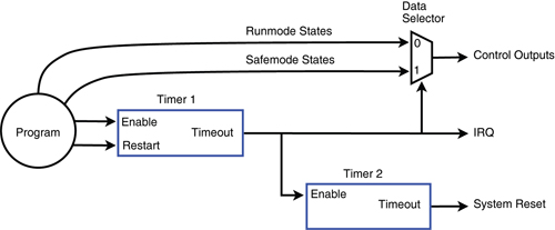

An abrupt system restart can be very expensive in terms of both downtime and loss of important state information. One or both of these costs can be mitigated with a multistage watchdog. This two-stage watchdog immediately switches the control outputs to safe states, but instead of triggering an immediate system restart, it schedules a deferred system restart and signals the computer, thus allowing time for the program to attempt to recover from the fault or log state information. If the program successfully recovers, the scheduled system reset will be canceled and the system will have avoided an expensive restart.
During normal operation, the program kicks Timer1 at regular intervals to prevent it from timing out. As long as Timer1 has not timed out, Timer2 is disabled and held at its initial value, and the control outputs are allowed to change under program control.
If a fault causes Timer1 to timeout, its Timeout signal will simultaneously switch the outputs to safe states, start Timer2 running, and request interrupt service. If the computer is able to respond to the IRQ, then the program will have an opportunity to try to recover from the fault condition or, if the fault is uncorrectable, then the program can save state and fault information. Upon successful recovery, the program will disable Timer1 (and by extension, Timer2), thus canceling the system reset. If the computer can’t respond to the IRQ or recovery is impossible, a system reset will be invoked when Timer2 times out.
If the program will never take advantage of the IRQ, Timer1’s timeout signal can be routed to the computer’s NMI (nonmaskable interrupt) input instead of a maskable IRQ input. In this case, a NMI notifies the computer that a system restart is imminent, and Timer2 will give it time to record fault information before the restart is triggered.

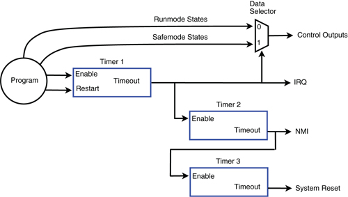

This multistage watchdog extends the two-stage watchdog by adding a third timer, making it possible to record debug information if graceful recovery fails.
During normal operation, the program kicks Timer1 at regular intervals to prevent a timeout. While Timer1 is running, Timer2 and Timer3 are disabled and held at their initial values and the control outputs are allowed to change under program control. As in the previous example, a Timer1 timeout will switch the outputs to safe states, start Timer2, and requests interrupt service. If the computer is able to respond to the IRQ, the program will attempt to recover from the fault condition and, if successful, the program will disable Timer1 (and by extension, Timer2), thus canceling further corrective actions.
If the computer cannot respond to the IRQ, or it takes too long to respond, or graceful recovery is impossible, Timer2 will timeout, which in turn will start Timer3 and assert a non-maskable interrupt request to indicate that a system restart is imminent. If the computer is appropriately configured and able to respond to the NMI, it will do so by logging important fault information (e.g., crash dump). The system will restart when Timer3 times out.
