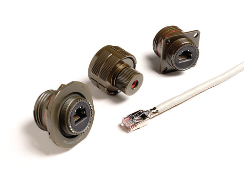

The mil spec high speed RJ45 and USB connector systems incorporate ABAC (MILDTL-38999 series III) or AB05 (MIL-DTL-26482) derived metal shells with full 360 degree EMC and mechanical protection.
10-gigabit-ethernet
These connectors provide high reliability through environmental sealing, enhanced mechanical protection and EMC performance. Across the range, all-metal housings ensure thermal resilience, enabling operation from – 40°C  to +120°C. Additionally, the high speed connector, ABAC R6A, enables data rates up to 10Gbit/s for CAT6a mil-spec networks.
The AB05 R6 bayonet connectors come with a high performance RJ connector, which is matched to the AB05 housing to guarantee mechanical, environmental and electrical performance. They provide up to 1Gbit/s transmission for CAT6e structured cabling, enabling fast data rates for 10 BASE-T, 100 BASE-TX, and 1000 BASE-T networks. Receptacles are offered in square or jam nut formats, along with complementary Type 60 cable plugs and protective caps.
