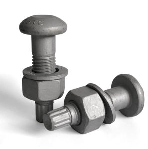

2. Hydrogen embrittlement protection
Infasco introduced a unique coating system for tension-control (TC) and hex structural bolts, providing several benefits compared to black bolts. According to the company, the new INF3013 far surpasses the performance of mechanically galvanized coatings. In fact, it’s achieved extended corrosion resistance of 1,000 hours of salt spray, which is at least twice that of a mechanically galvanized coating.
Additionally, INF3013 cannot generate hydrogen embrittlement and offers good short-term protection, allowing TC bolts to be inserted into structural connections and tightened at a later date without the presence of corrosive properties (which would typically affect the pre-load).
