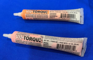

9. The detection marker. ND Industries is a go-to solutions provider for locking, bonding, and assembling fasteners. Along with its tape and threadlocking options, the company also supplies Viz-Torque Tamper Detection Marker — an inspection paste used to visually detect torque movement due to vibratory loosening or tampering of fittings, assemblies, nuts, bolts, and studs.
The Viz-Torque Tamper Detection Marker from ND Industries is a highly visible paste thatwill fluoresce under black light, making it easy to see.
The quick-drying tamper-proof torque marker identifies whether a part has been moved from its original position. Once dried in place, the marker creates a seal for torque movement detection, which allows the dry and brittle material stripe to break, providing proof of fastener tampering or loosening.
