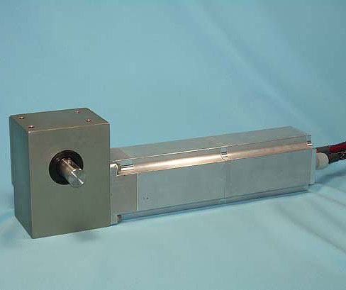

Bores: Basic items such as diameter, length of bore, and keyway are straight forward; however, hex, square, D or splined bores can be done. When your requirement is different than the standard bore it generally will be more expensive in prototype or small quantities.
Shafts: Usually the normal output shaft is round but it can be supplied as a hex, square, D or splined. Key slots need to be clearly specified as to length, width, depth and location along the shaft. Other alterations might include cross-drilled holes, milled flats or retainer ring groves.

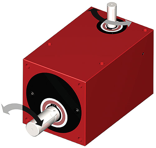

Output Rotation: Most gearboxes with clockwise (CW) input give a counter clockwise (CCW) output rotation. Worm Gearboxes and Helical Gearboxes can be supplied with left hand lead angles and they will then have a clockwise (CW) output when the input is turned clockwise. There are also gearboxes with dual counter rotating output shafts. The output direction of spur gear boxes depends on the number of gears used in the gear train.
