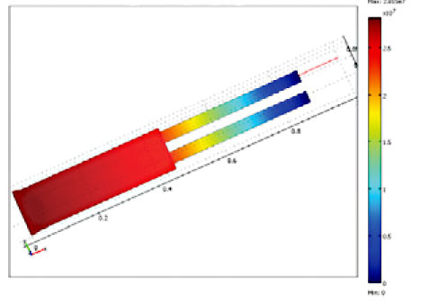

3D FEA analysis for the flow of LDPE was done using the COMSOL Multiphysics, non-Newtonian (Chemical Engineering Module). After re-modeling the existing die in the Solid edge 3D software, the Boolean feature was used to obtain the flow domain of the melt. Then the resulting model was imported to COMSOL software work station.
Parametric analysis is the most important part of the modeling where the parameters for solving any complicated function are defined. In this case, the aim of this model is to solve for the pressure drop in the die. Since the pressure at the outlet is zero, finding the operating pressure, p_in, at the inlet of the die is sufficient.
To help the convergence of the solution and reduce solution time and error of the iteration, a range of arbitrary but reasonable p_in parametric values were inserted. An approximated range for p_in values of 400 kPa to 2.8 MPa with a sweep of 400 kPa was chosen as a range since that is extruder common operating range.

The parametric solver solves the different input values of pressure in an ascending order. And hence, the value of p_in solved last (the highest value) will be displayed as a contour plot by default as the software converges.
Figure 1, pressure distribution in the die.

Pressure distribution in the die shows a condition when p_in value is equal to 28 MPa, Fig. 1. This figure does not necessarily imply that this value of 28 MPa is the operating pressure. For this to be an operating-point pressure it should deliver a uniform quantity of melt complying with the assumption of fully developed and incompressible flow.
