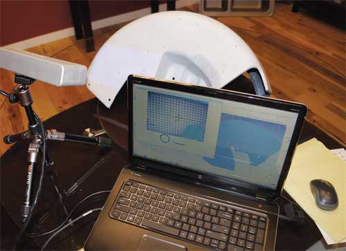

The company used Geomagic Capture from 3D Systems to capture and process the complex curves and intricate design points of the car. Geomagic Capture brings together a compact, ultra-precise, blue-light LED scanner and software that enables designers to quickly build a 3D model from multiple scans and import it directly into specific CAD applications.
When the Geomagic Capture system arrived, work began immediately. The first scans were of the Lotus’ front hood panel, requiring about 15 to 20 scans to capture.

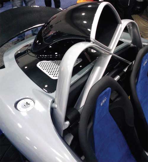

The finished assemblies created by C.ideas included the front hood, rear deck-lid, fenders and rear wing of the car. The deck-lid was modified after surface capture to include a cold air intake and vents. The wing was expanded to create greater drag at higher speeds. Original fiberglass parts, such as the front hood, were replaced with ABS parts that provide greater flexibility and resistance to cracking. Scans for the trunk were exported to PTC Creo software and sent out for additional design work.
Final models were printed in the materials best suited to meet design, performance and maintenance needs. 3D Systems iPro 8000 systems were used for all the stereolithography parts and the 3D Systems sPro60 HD/HS for the selective laser sintered parts.

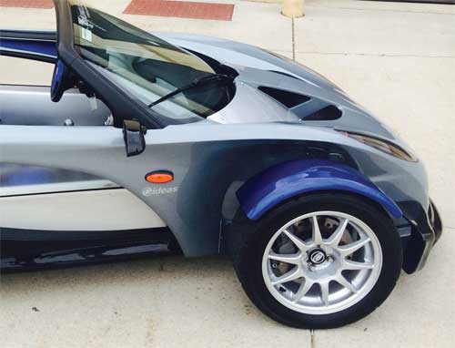

The fenders presented one of the greatest challenges. In the Lotus 340R, they’re free-floating above the wheels, protruding outside the body of the car in a motorcycle-style design, with tight-fitting cutaways to accommodate brake lines, springs and other components.
The dark-colored fenders were spray-painted in white rubber latex to facilitate scanning, after which the rubber was peeled off. Within three or four days, the fenders were recreated, 3D printed in ABS material and mounted.
