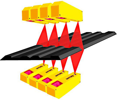

In-process inspections record profiles of tire-tread extrusions. Inspection stations located near the extruder die quickly detect and repair any process deviations. A typical application may use 8 or more sensors (4 above and 4 below the conveyor) to generate high-density data across the full width of the extrusion. With differential sensing, accurate profiles can be obtained even when the extrusion location is not controlled. An encoder mounted on the conveyor line identifies the position of each profile along the extrusion.

Four cameras above and four below the tread extrusion fully cover its surface. The system synchronizes the cameras and captures 3D images of both sides of the extrusion as it moves linearly under the scanning laser.
