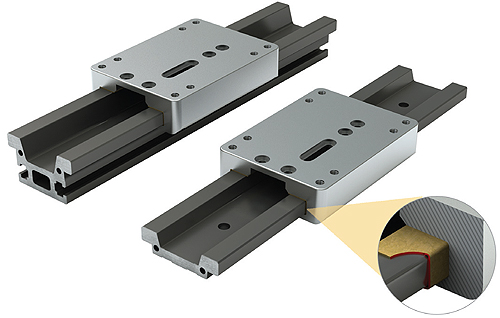

1. Guide Rails
Hardened steel round shafts or profile rails are ground to tight tolerances and offer a smooth running surface for bearings. However, when it comes to mounting them in parallel situations, they can be difficult to work with–requiring special fixtures, lasers, or other equipment for alignment. Any misalignment will result in inconsistent frictional forces, which will affect the desired smooth motion of a part, such as a camera or print head. In addition, mounting surfaces require precise manufacture as well, usually being ground or machined, which adds cost to the overall assembly.
v-guide-wheel-roller-bearings
V-Guide wheel roller bearings with qualified
hardened steel raceways hold tight tolerances for bow, twist, and warp.
One-piece pre-aligned rails or guides are available in various forms and offer an alternative to traditional component assemblies. Variations include:
• an aluminum base with either round or V-style hardened steel embedded raceways
• a complete aluminum extrusion designed to operate with sliding bearings.
one-piece-linear-guide-rail-comparison
Shown here–a graphical model of actual inspection reports for flatness, straightness and parallelism comparing multiple components to a qualified one-piece linear guide rail.
Be aware when evaluating aluminum rails that some hold “as extruded” tolerances that will not achieve the precision needed for scanning, printing, or machining applications. Advances in manufacturing methods by some manufacturers will produce tight tolerances for bow, twist, and warp while maintaining the cost advantages of an aluminum extrusion. Additionally the pre-alignment of raceways cuts the cost of assembly and produces consistent results in input or output devices.
individually-mounted-guide-rails
Individually mounted guide rails are difficult to align, adding cost and reducing performance.

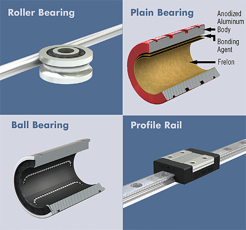

2. Bearings
Plastic insert bearings (which are a common choice in low-cost scanning, printing, and subtractive machine designs) are usually low in cost, but tolerances may not be as tight as necessary for the application. The plastic is injection molded and so may not have undergone machining operations to the inside diameter. Often, tolerances are not sufficiently tight for the extruded aluminum rail the plastic bearings run over. The lack of tolerance control on both parts can impact frictional forces within a single piece of equipment and make repeatable assembly from machine-to-machine difficult.
plain-bearings-with-PTFE-liner
Plain bearings with PTFE based Frelon® liner eliminates metal-to-metal contact and is self-lubricating.
Recirculating ball bearings, whether round or square bearing blocks, provide stiff preloaded low-friction motion, which can overcome some misalignment issues. With good loading and moment capacities, bearings deliver a rigid, precise movement over the rail because play is eliminated. However, true precision is ultimately a function of the entire system working together, including power transmission and electronics.
Problems can arise in quality output due to metal-to-metal contact. The small ball elements not only contact the steel shaft, they also bang against one another creating impact vibrations, which are picked up in the electronics. This action can result in irregular artifact lines on both digital images and in printed parts.
Roller bearings minimize the metal-to-metal contact to a single line for each bearing while maintaining preload adjustability. They also move smoothly for high-speed operation, such as that found in extremely fast printing applications. Roller bearings have load capacity advantages especially where moments or side loading are factors. They can be sealed against contamination and the large wheel diameter is good for rolling over or moving particulates.
Bronze bearings riding on a round hard steel shaft are another alternative. They have a high coefficient of friction that tends to remain consistent, but the metal-to-metal contact along with relaxed tolerances can reduce quality output.
types-of-bearings
A bonded PTFE based bearings is an alternative that eliminates metal-to-metal contact and has the most consistent coefficient of friction performance, along with being precision ground to exact tolerances. The material is also adaptable for use on both round shafts or pre-aligned rails and guides. These features help to produce quality results in both input and output devices.

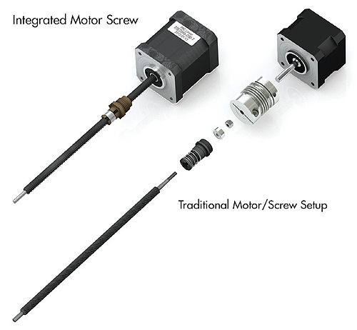

Ease of Assembly: A prime consideration for any system is the ability to make and assemble various components easily at low cost while maintaining consistent alignment. One example would be the connection of the motor to a lead screw. By integrating the screw with the motor and eliminating a coupler, not only will the assembly process be simpler and the number of parts and cost reduced, but the quality will improve as well. Tolerance stack up is eliminated, reducing concentricity and runout while improving rigidity. Kinematics is also enhanced due to a reduction in the rotating inertial mass.

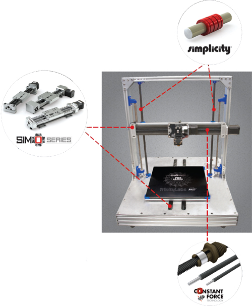

PBC Linear® helps Trinity Labs Build 3D printing Success
Trinity Labs is a Cartesian robotics R&D company located in Portland, Oregon that “envisions a world in which the conventional barriers between idea and reality are a thing of the past.” Their dedication to this goal goes far beyond words as they continually develop and advance 3D printing (3DP) technology–while making it accessible to both the hobbyist and serious engineer alike. With a range of components for the RepRap community, retrofit kits for those looking to upgrade, and complete professional desktop 3D printers, Trinity Labs makes it easy to engage in the 3DP realm without the high startup costs associated with many rapid prototyping options.
aluminatus-3d-printer-with-pbc-linear-components
The Aluminatus 3D Printer from Trinity Labs utilizes Simplicity plain bearings, Simo Series linear stages, and Constant Force Technology lead screws from PBC Linear.
A key facet of the quality that Trinity Labs offers is the stable motion provided by PBC Linear for the “X” and “Y”-axis. The low profile UniGuide™ (UGA) is a simple 2-piece system. It is made up of a one-piece linear rail that has all of the critical surfaces machined with the patent pending one-pass SIMO® process developed by PBC Linear. This process virtually eliminates bow, twist, and warp for a precise, but cost effective linear guide. The carriage is also aluminum with integrated bearing pads permanently bonded directly to the carriage. These bearing pads are made of FrelonGOLD®, a PTFE based material that is self-lubricating, and that delivers consistent smooth motion. The clearance between rail and carriage is held to exacting tolerances, creating a tight fit to the rail that is reflected in the quality output. This ultimately leads to greater control of the buildup of materials on the 3D printer bed. Together, the UGA rail and carriage assembly are part of a retrofit kit for existing machines in the field and for the redesigned MendleMaxPro model from Trinity Labs.
FrelonGold
The original design used a dual shaft linear system with bronze bushings. It required multiple components, fixtures, and a time-consuming assembly process to align the shafts so the bearings would move freely without binding. The 2-piece Uni-Guide design eliminated these assembly and alignment processes, saving time and making it an easy field retrofit for existing machines.
For the retrofit kits for existing printers, Ezra Zygmuntowicz, Founder and President of Trinity Labs said, “This is now the highest quality Y-axis solution in the open source RepRap 3D printer community ecosystem. The low profile UniGuide has given us a huge improvement in performance and customer satisfaction. It really caused a stir until we began shipping because people were so anxious to get the new version of the MendleMax. Our orders have just exploded. In addition, we have started using the UniGuide in a Y-axis upgrade kit for the Prusa Mendel RepRap printer. There is a large install base that will love to get their hands on this.”
