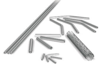

1 Watch tolerance stacking. When you are figuring tolerances in terms of upper and lower extremes, also take into account tolerance stacking and the effects of secondary operations and ID clearance issues. Accounting for these factors in a design prior to prototyping will save money and time.
2 Don’t use unqualified input. While the Internet is a source of information, not all the information on it is accurate. Vendors and suppliers may not be rigorous in ensuring that the information on their sites is up to date. Said Lance Heft, CEO of International Tube, “The trouble with the Internet and even some reference books is that they may encourage the selection of an exotic material that could be unavailable or inappropriate for the application. Your supplier should be able to explain such issues.” It is helpful to fully understand the different manufacturing methods of tubing and how this relates to the performance of the end product.
Many tube designs and configurations include fabrication challenges such as metallurgy, tube formation and configuration, tensile strengths, cost, structural characteristics, and coatings. These may include bulges, flairs, and swages that are difficult to perform, yet may be vital to the performance of a device. So, it is important to confirm that your supplier has experience with such configurations.
